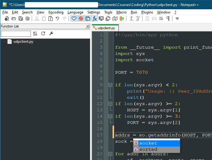

            @TBugReporter Peter is correct about this. You can change GUI elements - including the AutoComplete background and highlight colors with newer Notepad++ because of the updated Scintilla editing component, but you need a “Scripting” plugin (e.g., NppExec, PythonScript) to do it.
            This my setup for example using a modified Obsidian theme and PythonScript for GUI element colorization:

                        This is super simple in NppExec:
                        SCI_SENDMSG SCI_SETELEMENTCOLOUR SC_ELEMENT_LIST_BACK <COLOR>
                        where <COLOR> is the integer of the RGB color you want to use. The only issue is that it only works on the current Scintilla view so you need to set it again if you use the second view.
                        See Scintilla docs (SCI_SETELEMENTCOLOUR ) for more info.
                        This can be done similarly in PythonScript, but I’m running the latest version (3.0.14) so make no guarantees this will work in PythonScript 2.
                        from Npp import *
                        for ed in editor1, editor2:
                            ed.setElementColour(ELEMENT.LIST, (0, 0, 0))
                            ed.setElementColour(ELEMENT.LIST_BACK, (144, 144, 144))
                            ed.setElementColour(ELEMENT.LIST_SELECTED, (255, 255, 255))
                            ed.setElementColour(ELEMENT.LIST_SELECTED_BACK, (0, 128, 255))
