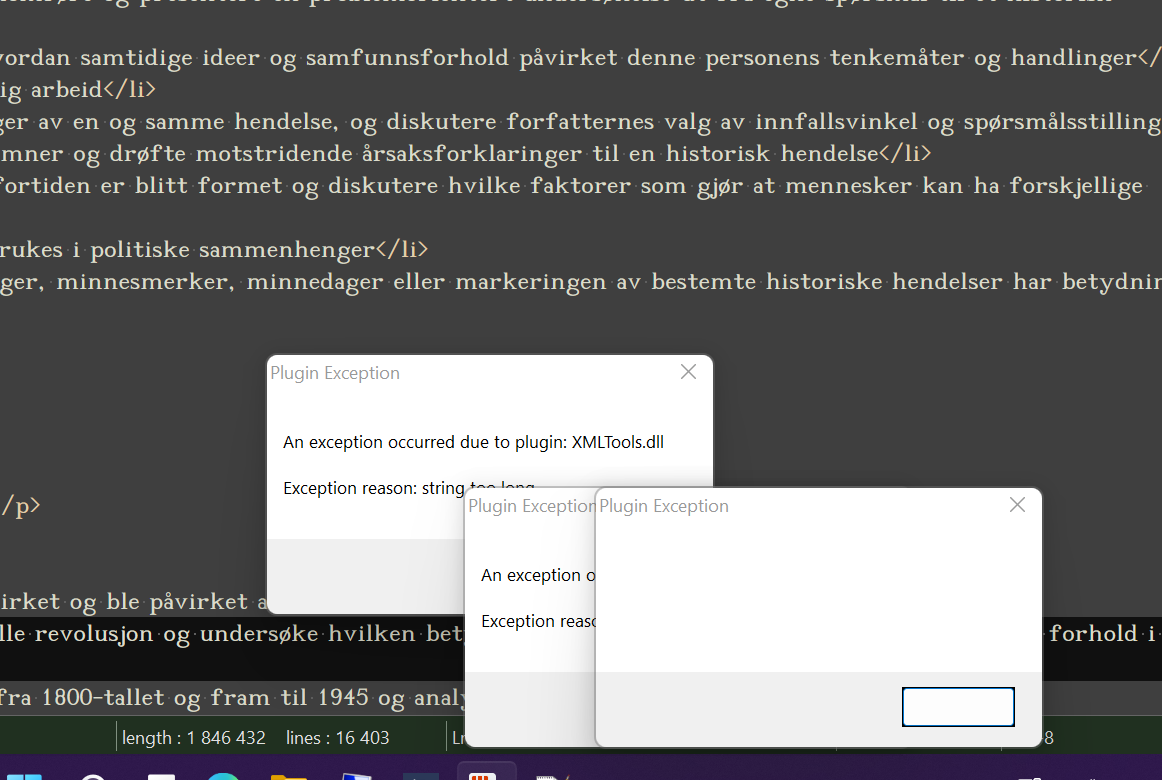

I removed all the plugins, but reinstalled xml-tools to be able to validate. There seems to be some issues with this plugin, using “go to next error”-feature closed Notepad++ all togheter, without warning. I deleted the plugin again, and then it all went bad:
These came poping up every time I tried to start Notepad++, even though there was no plugins installed. And the toolbar stopped function, turning white.

I fail to understand how, if the XMLTools.dll was removed, that Notepad++ could pop up that error message.

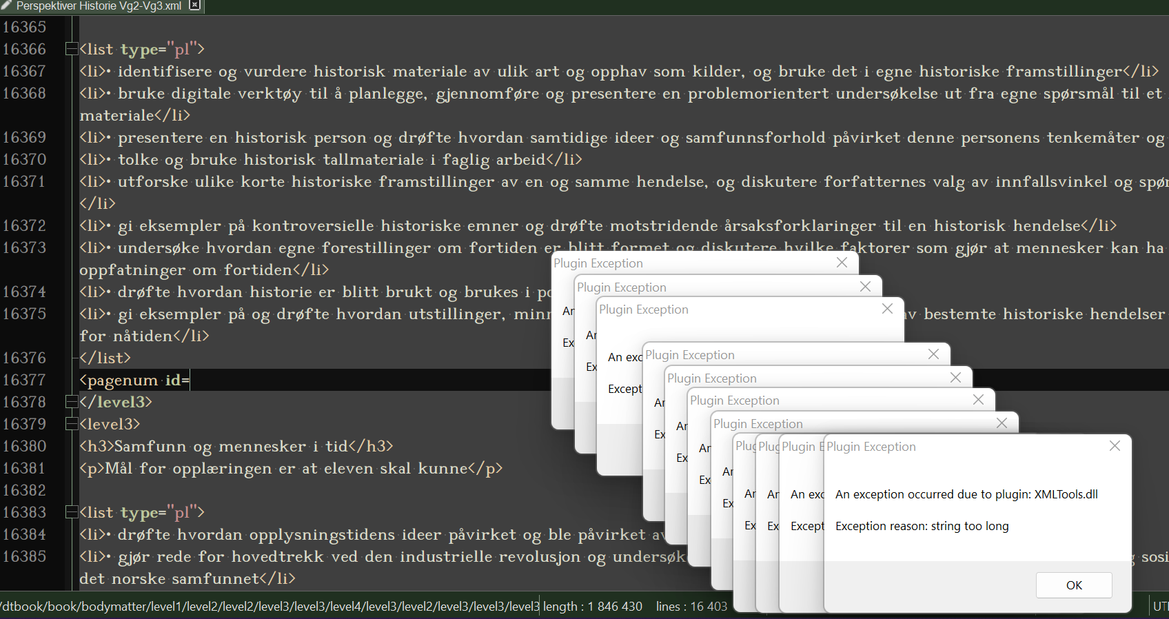

Well, I don’t know, but it started with this:
This prompted me to uninstall the plugin.

I wouldn’t rely on Notepad++ to remove the plugin when it asks you if you want this. There was a report recently with the CSVLint plugin, that even if you tell Notepad++ to remove it, it doesn’t.
Thus it could be for you that you only think it has been removed, and when it hasn’t and you restart, those popups occur (and actually make sense).

Your error messages show that you were not successful in removing the plugin again. Alan gave some pointers as to an area of confusion in that regard.
So I reinstalled Notepadd again.
If you didn’t remove Notepad++ completely before installing it again (deleting the install directory
C:\Program Files\Notepad++\and all its subdirectories), that will not help either. -
