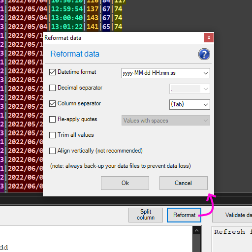

      1. The generic darkmode render code also doesn’t support any other popup dialogs that are opened by the FWDataViz plugin. This clip was taken by turning off FWDataViz’s own darkmode rendering, and with just NPP’s generic darkmode rendering in action.
      2. In view of the preceding observation and to avoid the needless double rendering of darkmode for the plugin, I had to add the DWS_USEOWNDARKMODE flag to FWDataViz’s dock panel creation code to turn-off the generic darkmode rendering from NPP, and turn on the FWDataViz’s custom darkmode rendering.
