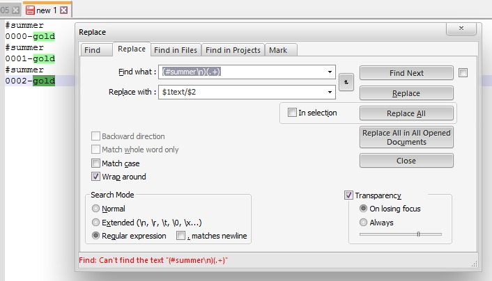

          • cisco779kC Offline
            cisco779k @Lycan Thrope
            @lycan-thrope said in add text to even lines:
            Find: (#summer\n)(.+)
            Replace: $1text/$2
            yes, this command does not work
                cisco779k @Terry R
                thank you to all for replies
                anyway, thank to suggestion by Alan Kilborn, the string by Lycan Thrope work fine with simply replace:
                find what: (#summer\R)(.+)
                replace: $1text/$2
                cisco779kC 1 Reply Last reply Reply Quote 2
