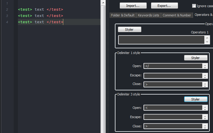

      Hello,
      I created my own language but I would like to know how to display two delimiters that are very similar.
      When I use < >, it works like a charm but it does not take into account </ >. So I tried to add another delimiter, but </ > cancels the previous one. It seems to be difficult to cohabit < > with </ >. It’s one or the other.
      Is there a simple way to solve the problem, please?
      Example here: https://ibb.co/S0wshRy
      The Connections placed between </ > should be blue as the first one.
      Thanks,
      Cyril.
        Ekopalypse @Cyril Délécraz
        @cyril-délécraz
        If one is a subset of the other, make sure that it is evaluated after the other.
        Cyril DélécrazC 1 Reply Last reply Reply Quote 4
        • Cyril DélécrazC
          Cyril Délécraz @Ekopalypse
          @ekopalypse Thank you very much, it works like a charm.
