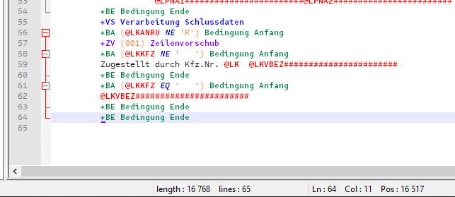

      I often have long text files, that are written in a Pseudo-Code, those files are basically
      instructiosn how to print something, they also have “blanks bevor starts” now some of them have 3 othres 10 or another number.

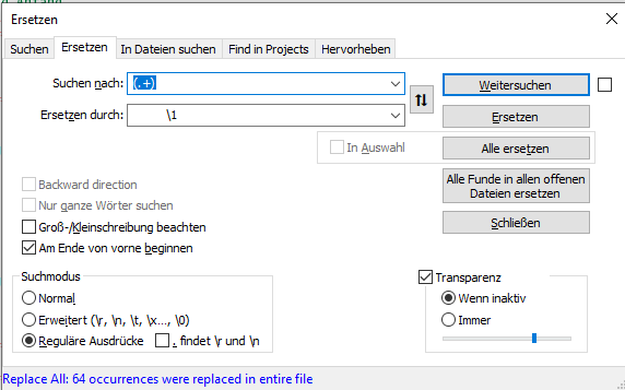

      now when I’m chekcing theese files in notepad++, which is greate because of some custom syntax-highlighing i worte, i have a need to see the positinos of the elements on there true posistions. In order to get this i usa the find and replace function with regex:
      this works but is somewhat anoying.

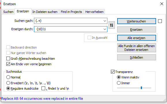

      is there a way to set the number spaces liek [space]{10}\1
      this does not work:
      What am I missing? Or is this a limitation of RegEx , or our RegEx flavour?
      PeterJonesP Neil SchipperN 2 Replies Last reply Reply Quote 0
        PeterJones @black_cat
        @black_cat said in RegEx set number of spaces bevore captured group in replace:
        I have never seen a flavor of regex that has quantifiers in the replacement section. That might be nice, but I haven’t seen it before. Sorry.

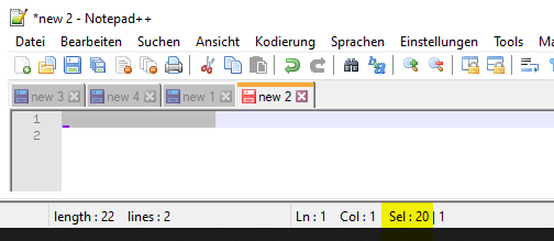

            @Neil-Schipper if I have to use a larger number of blanks i usually mark them in notepad++ in an empty new tab and count the selection:
            It just would have been niche to sovle this with a RegEx quantifier, but if it isn’t there it isn’t there. ^-^
