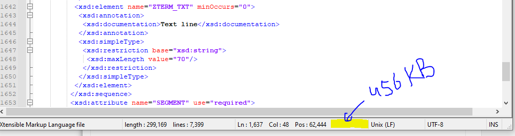

      Just a suggestion:
      It would be great if we can see the file size under the status bar of an already opened file in the Notepad++.!

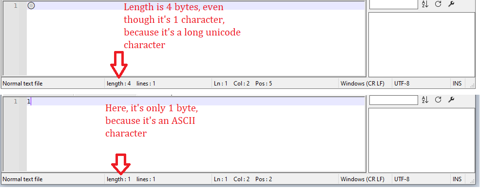

          It matches the length in bytes, not in characters

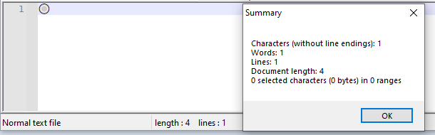

          Or, looking at the long unicode character’s document again, with the View > Summary showing as well:
          The Length in that status bar is the number of bytes in the file. It isn’t in the accuracy-reduced “456kB” format that @Adil-Aleem suggested, because it’s showing the full number of bytes, not divided or rounded to show K, M, G, etc.
