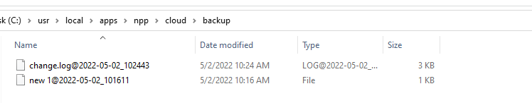

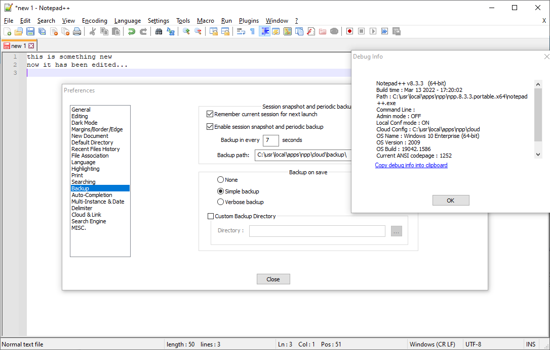

            Not for me. It works exactly as I expect:
            • set the cloud to c:\usr\local\apps\npp\cloud
            • restart Notepad++ so that it is actually using the new configuration
            • add some text to a new file
            • confirm that the backup is set to c:\usr\local\apps\npp\cloud\backup
            • look at Windows explorer and see that the c:\usr\local\apps\npp\cloud\backup contains the backup for that unsaved file
            • open change.log in Notepad++, add a space character, wait 7 sec, see change.log@##### appear in the ...\cloud\backup folder.
            For me, session snapshot and periodic backup correctly saves backups of edited-but-not-saved files into the folder defined by the cloud settings and backup settings. So I don’t see a bug in the implementation.
