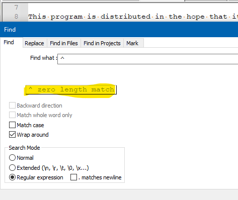

      Here’s an interesting one. If you do a regular expression search for ^, for example, Notepad++ will put up an annotation indicating ^ zero length match. However, if something else (e.g. the Find window) is in the same screen space, the annotation will appear closer to the user than the other entity. Perhaps a screenshot helps:
      Here the annotation should clearly be under the Find window, not on top of it.

        @alan-kilborn said in Bug with annotations relating to z-order:
        Not to be pedantic, but that actually isn’t an “annotation” in the sense of a Scintilla annotation. It’s actually a “calltip” in the Scintilla sense. Using those terms in the issue report may help a quicker fix?

          @michael-vincent said in Bug with annotations relating to z-order:
          I was actually working on some script code that deals with annotations at the time I noticed that, so I guess that was on my mind. :-)
