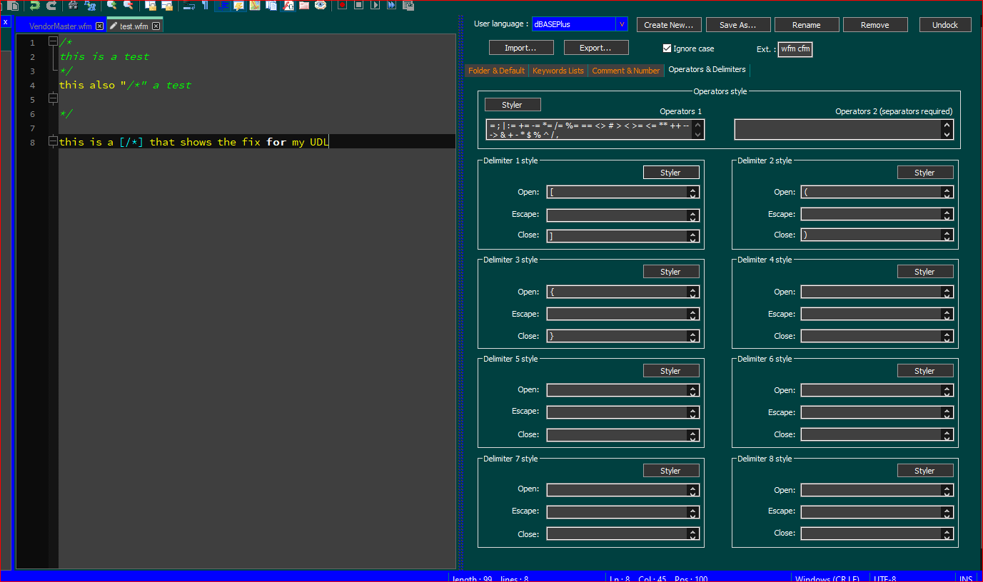

        You might want to use something other than quotes. My UDL for dBASE allows for square brackets to also be used to delimit strings, and I ended up with the same problem you did with the open /* symbols, until I enclosed them in the [] delimiters. It depends on how your UDL implements various aspects of the language, that determines how it’s going to show up in NPP, so you may need to use a set of delimiters for encasing the string that works. The problem is that some of the UDL uses quotes to encase two word keywords, and such, so I had trouble when using the quotes since for some reason they didn’t delimit or they delimited too much like you just showed. My problem came originally from typing something like it's and that apostrophe would start the highlighting and never find another closing apostrophe to stop it. I removed the quotes also, for similar behavior I think, because in dBASE, SQL commands that can be sent via a function, need to be enclosed in single quotes, and then other strings inside would be enclosed by double quotes…etc, so I just removed them from any special highlighting.
        The crux of this, however, is that it doesn’t actually affect your code, just how you see it in NPP via your UDL. Try using a different delimiter and see if that doesn’t allow you to enclose that character set without triggering the behavior you see. Here’s a screen shot of what mine does.

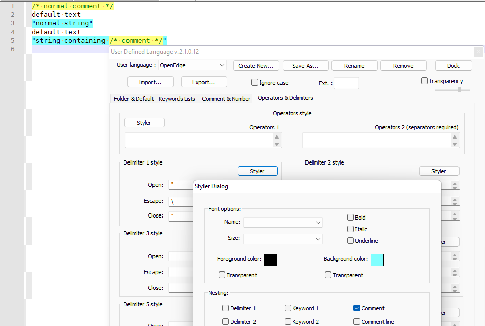

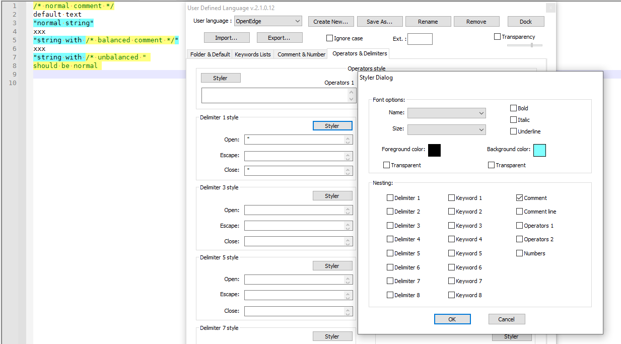

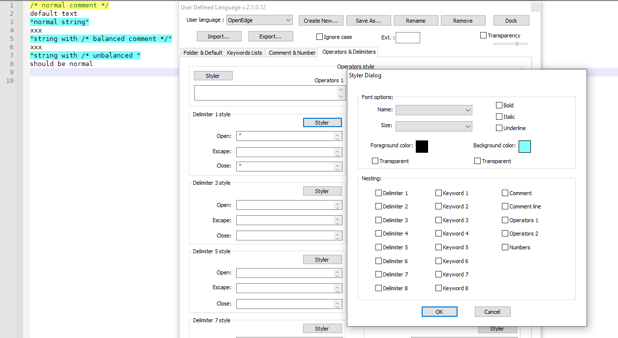

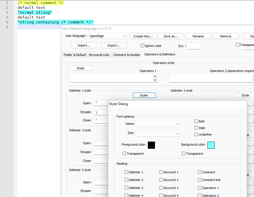

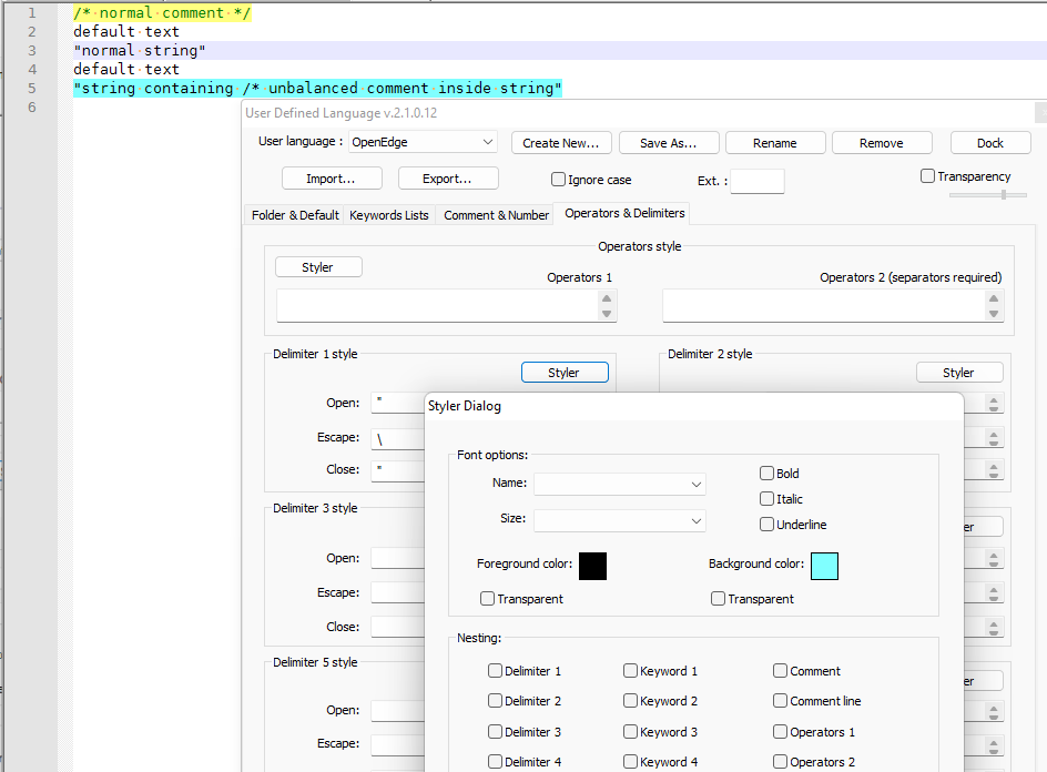

          If you define the quotes as a delimiter pair, it will only allow a comment in that delimiter pair if you tell it to allow it:
          example: comment not allowed inside quote delimiter: ed9af1a8-3054-4585-80bc-63a1f2b14ff4-image.png
          unbalanced version: 4c8bb75a-8019-494c-b220-cf4beac4bf9a-image.png

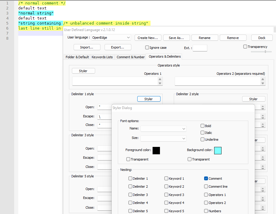

          example: comment is allowed inside quote delimiter: f2722b7a-fbbb-407a-bfaf-3465da05f6ee-image.png
          unbalanced version (replicates the problem you described): 1ae632b3-0ea7-4c32-b74b-a5630e662158-image.png

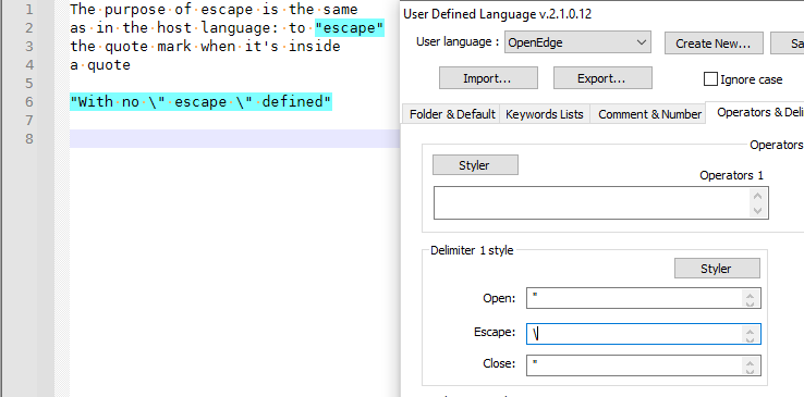

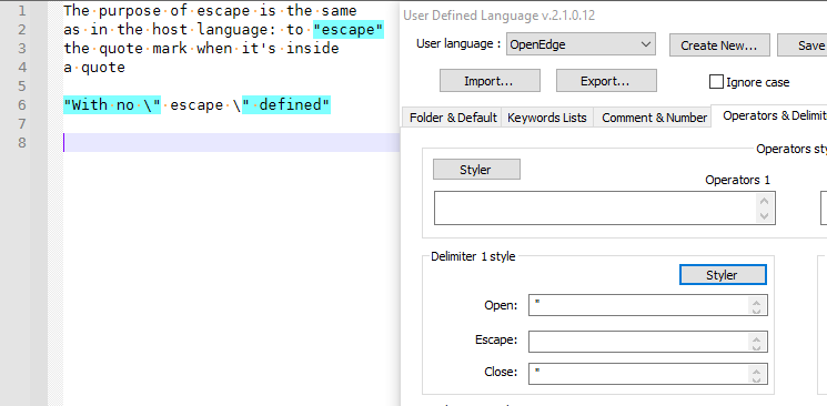

                I put in the Escape out of habit, and I’m glad you’ve now learned of its existence… but Escape had nothing to do with whether or not the Comment-start inside the string was recognized as a comment or not. The nesting decision is fully determined by the checkboxes in the Nesting section.
                Checkmark not checked:
                Checkmark checked:
                Regarding the Escape:
                With no escape defined:
                With escape defined as backslash:
                our language doesn’t allow for comments inside of quotes/strings
                Right. which is why in the Styler for the quote delimiter, you have to make sure that the checkbox for comments is NOT checked, so it doesn’t try to highlight the text inside a quote as a comment, even though it may use those characters.
