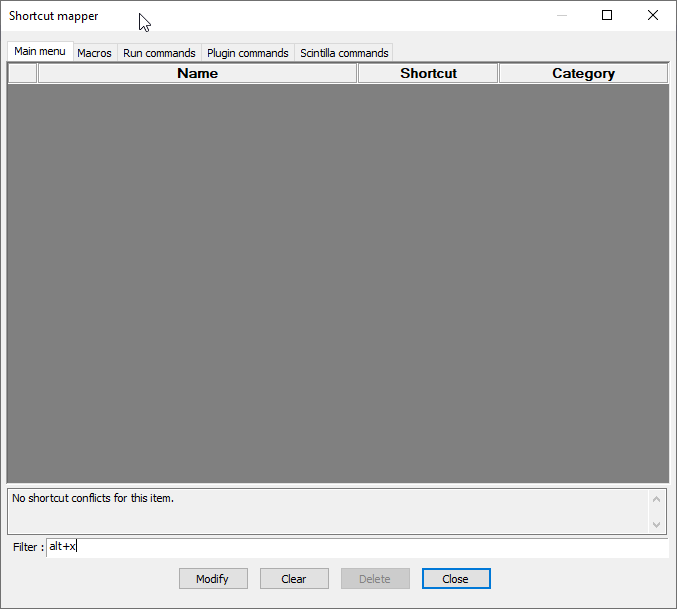

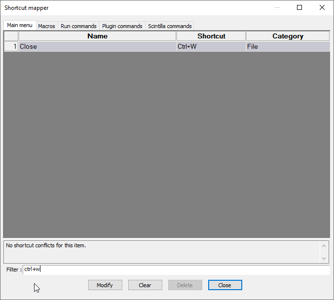

      I looked in Settings -> Shortcut Mapper and I could find Ctrl+W, but no Alt+X
      I would love to be able to turn Alt+X off because of my particular situation. Doing that in the Shortcut Mapper seems a likely place.

      Ctrl+W (Main Menu - File - Close):

      Alt+X (not found in any tab):

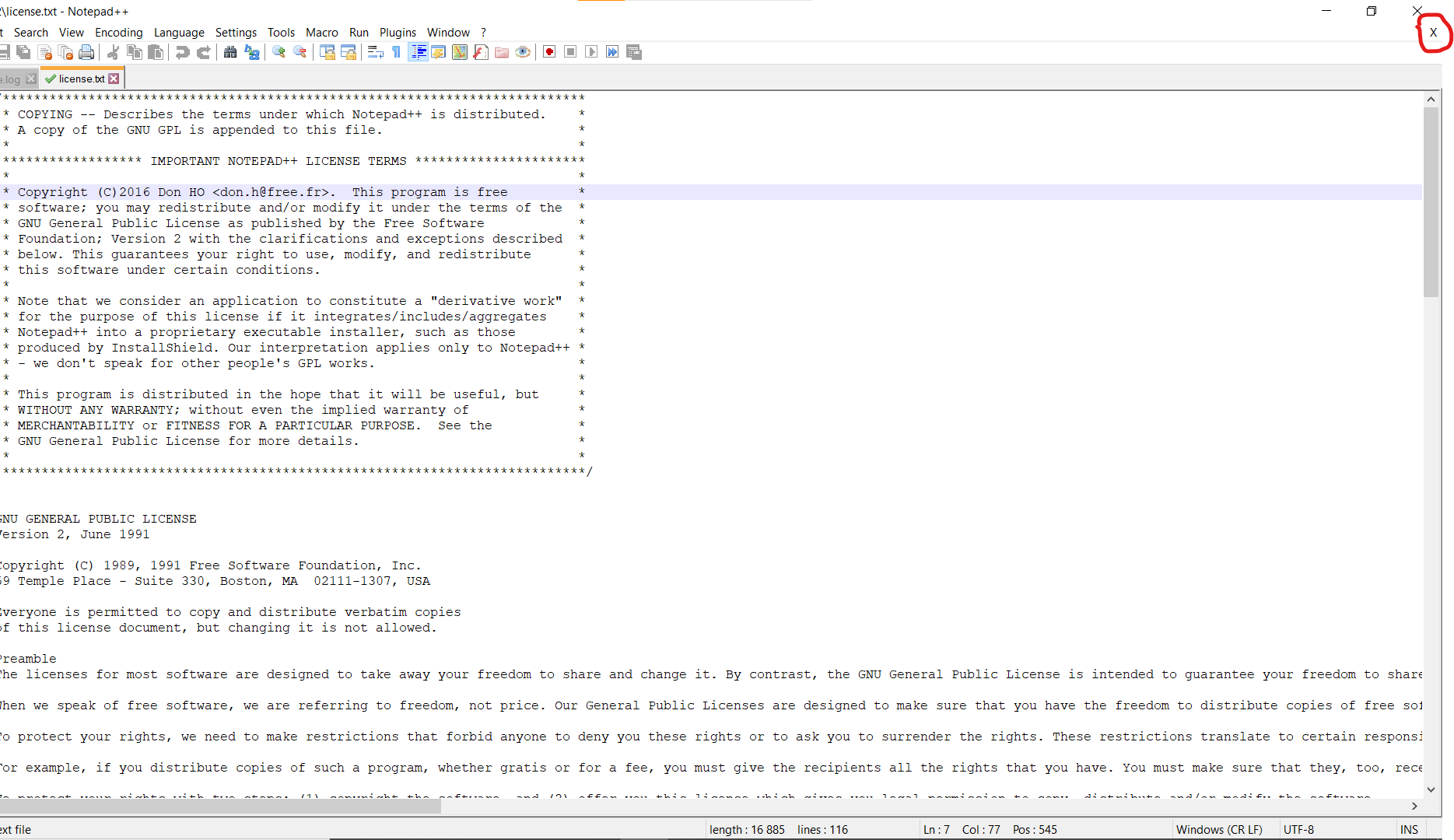

            Hello, @mm-john, @peterjones, @neil-schipper and All,
            Peter, I think that is a regular N++ shortcut ! Indeed, see the picture below :
            If you click on the red cross, at the very end, on the right, representing an uppercase X letter, it just closes the current file !

              Guy, I think you misunderstood me. I have no doubt that the “close the active file” is a valid control that can be activated by keystroke. It’s also on the tabbar the red x next to the title of the tab; and in the tabbar right click menu. And finally, and most obviously, it’s available as File > Close. But the shortcut for File > Close defaults to Ctrl+W as can be seen in that menu and the shortcut mapper.
              The reason I called the Alt+X mapping a “backdoor” and rather than the standard shortcut-definition process is because the Alt+X doesn’t show up anywhere in shortcut mapper, and when you try to program something else to Alt+X, it doesn’t tell you there is a conflict, even though that shortcut is assigned somewhere else (magically, from the perspective of Shortcut Mapper).
