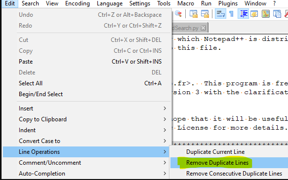

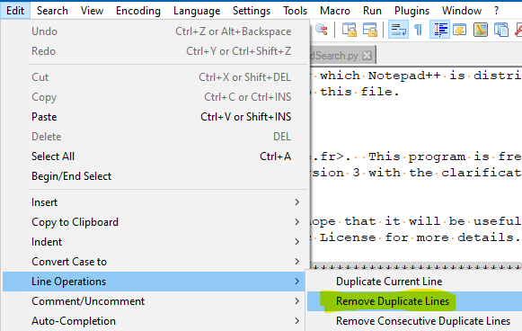

        Alan Kilborn @Roger St-Onge
        @roger-st-onge
        Find: (?-s)^(\d+)\..+
        Replace: ${1}
        Follow that with this action:
        Lycan ThropeL Roger St-OngeR 2 Replies Last reply Reply Quote 4

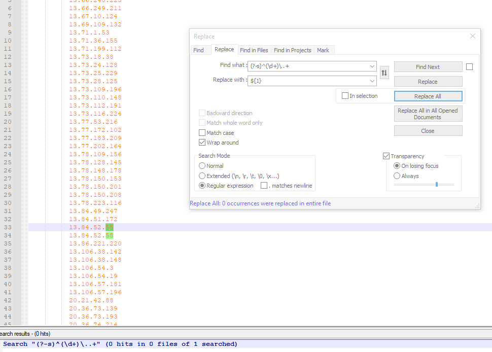

            @alan-kilborn, look like it’s not finding anything…376221ff-ce11-4d35-af78-761a01f71c9c-image.png

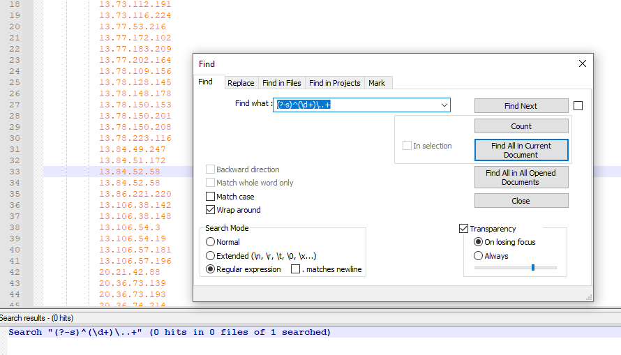

              @roger-st-onge Still having issue, not able to make it work5c4a0f86-258f-4e2a-a3b0-1b797eb3dd47-image.png
                @roger-st-onge
                It’s because you misrepresented your data.
                What you showed originally started in column 1 (well, as far as anyone could tell).
                The ^ in the expression means start-of-line must occur there.
                Experiment with removing that character from the find expression.
                Also a good idea to read up on regular expression searching; see this site’s FAQ page.
                Roger St-OngeR 1 Reply Last reply Reply Quote 3

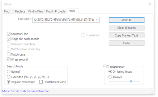

                  Solution to clean up AWS Public IP list
                  https://ip-ranges.amazonaws.com/ip-ranges.json
                  Removed all alphabet: \b(25[0-5]|2[0-4]\d|1\d\d|[1-9]?\d)(.(?1)){3}\b
