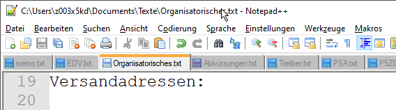

      Is it possible to make the red icon of a tab what has been changed a little bit more visible?
      It’s very had to spot this red icon when the tab is in background (red icon on grey):
      2022-03-30 15_23_27-C__Users_z003x5kd_Documents_Texte_Organisatorisches.txt - Notepad++.png

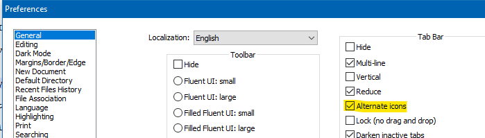

        No, but you can use the alternate icons for a better experience:
        Example:
        • ollixx77O
          ollixx77
          Great, this helps a lot. Thanks :-)
