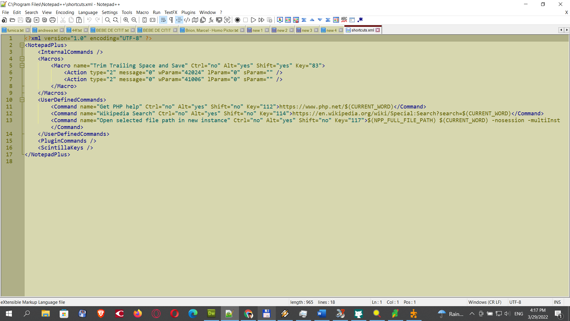

              thank you all. But there is a problem. I already made 2 macros, and save them. See picture 1. The problem is when I open shortcuts.xml, I cannot find the macros which I saved (see picture 2)

                • PeterJonesP Online
                  PeterJones @Neculai I. Fantanaru
                  @neculai-i-fantanaru said in Recording: How can I change the regex operations in MACRO?:
                  The Macro > Save Current Recorded Macro… action saves to memory. It is not until you exit out of Notepad++ that the macro gets moved from memory to shortcuts.xml. If you want to see the macro in shortcuts.xml, you have to exit Notepad++ first. See also the User Manual’s section on Editing Configuration Files
                    Alan Kilborn @Neculai I. Fantanaru
                    The shortcuts file that your N++ is probably using is in the %APPDATA%\Notepad++ folder. Paste that into an Explorer window to quickly go there and check that file.
                    Neculai I. FantanaruN 1 Reply Last reply Reply Quote 3
                    • Neculai I. FantanaruN Offline
                      Neculai I. Fantanaru @Alan Kilborn
                      @alan-kilborn
                      Yes, indeed. The location of shortcuts.xml is:
                      c:\Users\COMPUTER\AppData\Roaming\Notepad++\
                        That isn’t an absolute. Maybe for you it is, but it depends upon your setup. If you look at your Debug Info… (on the ? main menu), example:
                        then yes it is in %APPDATA%\Notepad++.
                        but if it says:
                        Local Conf mode : ON
                        then it is in the same folder as notepad++.exe.
                        Also, there is more info on “appdata” HERE … I should have pointed that out before.
