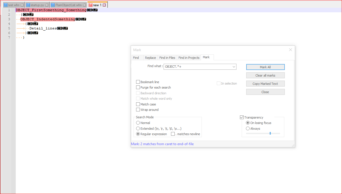

        You might try this instead, since when I copied your code, I could only highlight one line, removing the ^ allowed the two ‘Object’ lines to be found. With the caret there, it only found the one.
        Find: OBJECT.+
        Here’s a screenshot of Find/Mark in NPP to show my results:
          PeterJones @Lycan Thrope
          @lycan-thrope said in FunctionList issues:
          @Pat-Sinclair , with @Lycan-Thrope’s suggestion, it might match a line that says
          SomethingElse_OBJECT_Here that you don’t want it to match.
          if I were changing your expression to work with OBJECT_IndentedSomething, I would actually change it to mainExpr="^\h*OBJECT.*", which will still anchor to the beginning of line, but allows whitespace (spaces and tabs) between the beginning of the line and the OBJECT. This prevents anything but whitespace to be between the beginning of the line and the OBJECT,which I think is what you want.
