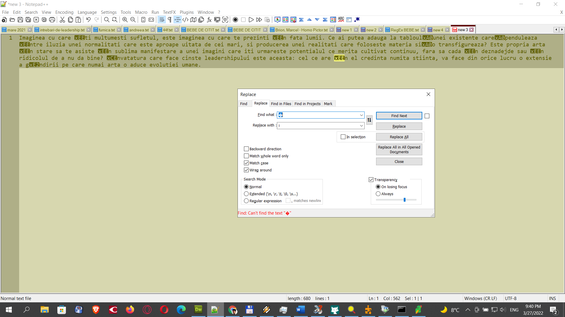

        • Neculai I. FantanaruN
          Neculai I. Fantanaru @Alan Kilborn
          @alan-kilborn is an observation. :)
          I wonder if you have encountered this problem before and how can it be solved?

                @Neculai-I-Fantanaru ,

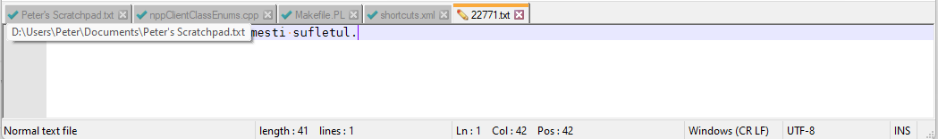

                Your subject of “can’t find ASCII characters” is a misphrasing of the problem you are having. The problem is that you have selected a non-ASCII character (not in the 7bit range; all ASCII characters are 7bit; anything in the 128-255 is non-ASCII, either part of the badly named “extended ASCII”, or one of the ANSI-style encodings which uses ASCII as the first 128 characters and a well-defined character in each of the other 128 positions, depending on which character set it came from). In fact, it is a byte that is not a valid UTF-8 character as currently encoded (specifically, the xEE in a black box, which represents the byte 0xEE).
                Your status bar shows that Notepad++ was reading the file as a UTF-8 file, in which the byte 0xEE is not a valid character by itself; the byte 0xEE in a UTF-8 file is supposed to be the first byte of a three-byte sequence: the first byte will be somewhere between 0xE0 and 0xEF, and the second and third bytes must be in between 0x80 thru 0xBF. The sequence Notepad++ found was 0xEE followed by an n (in the one that’s highlighted yellow in your screenshot), which is 0x6E. The byte sequence 0xEE 0x6E is not valid UTF-8 (guesswork on what it really is, in a little bit). So you misunderstood the file when you told Notepad++ to interpret it as UTF-8, or Notepad++ mis-guessed that you wanted it to be interpreted as UTF-8, or the file was meant to be UTF-8 but has errors of some sort.
                If your goal is to take that character, and replace it with an i, it is possible to do. But when you selected the “charcter” xEE, which isn’t a real character, Notepad++ couldn’t find it. Instead, if you switched to Regular Expression mode, and searched for \xEE, as @neil-schipper hinted, it will match that byte, even though it isn’t a valid character.
                However, I think you are going about this wrong. You should just tell Notepad++ what character set was really used, rather than letting Notepad++ think that your file was UTF-8.

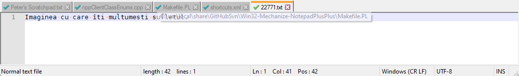

                When I typed your first three words Imaginea cu care into Google translate, it said it was Romanian for “The image with which…”. Looking up Romanian characters sets, I see it might be ISO 8859-2, in which case the xEE might be î, which would be Imaginea cu care îti multumesti sufletul which Google says means “The image with which you satisfy your soul”, which might be a valid phrase, so it might be that your file is actually ISO 8859-2. Alternately, 8859-16 also has the same character at codepoint 0xEE. And really, even 8859-1 has î at that codepoint. (And since you want to replace it with an i, that seems like I might be on the right track.)

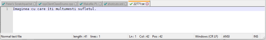

                Assuming your file is really 8859-2, to “fix” Notepad++'s interpretation, just go to the Encoding menu, and first choose ANSI, so that it’s not trying to read those bytes
                1. Original Interpretation:
                2. Encoding menu, ANSI:
                  119bf4d4-9186-438a-a103-c3e4d9c851a0-image.png => 6a03ac32-d132-4c98-8d75-1383fd59bc94-image.png
                  And now it will probably be correct.
                3. If you have other characters that weren’t interpreted correctly, then it didn’t pick the right character set for your ANSI file, so you might go to Encoding > Character Set > Eastern European > ISO 8859-2 or some other
                At this point, if you want to save the file as UTF-8 (which I recommend, because that is more universal), then go to Encoding > Convert to UTF-8 (not to be confused with **Encoding > UTF-8, which will just get you back to the wrong interpretation that you showed above):
                It will still show the right characters,
                but once you save, the î will be represented on disk as the bytes 0xC3 0xAE, which is the correct way to encode U+00EE, and Notepad++ should interpret it correctly from then on out.
