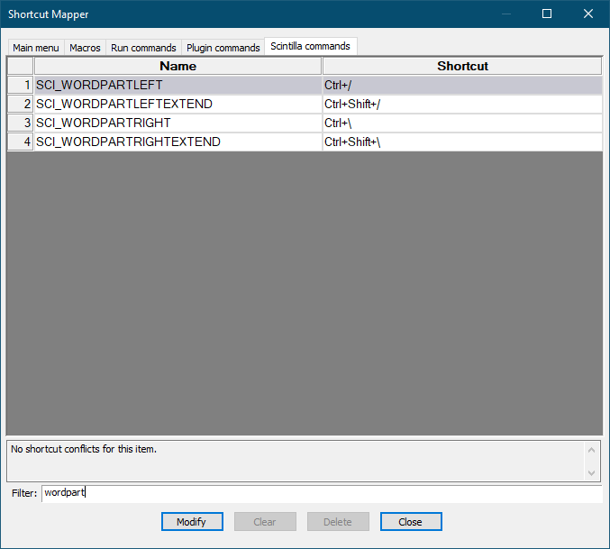

                                Scintilla has commands associated with word part navigation. However I’m not sure if Notepad++ exposes these to be mapped to shortcuts or not.
                                  Michael Vincent @dail
                                  @dail said in Is there any subword navigation support?:
                                  @Earth-Invader
                                  They are:
                                  Neil SchipperN Earth InvaderE 2 Replies Last reply Reply Quote 7

                                    @michael-vincent Funny, I just started playing around with those like in the last 24 hrs (and gave them a mention in a post in a different thread). I’d been wondering, “why do these even exist? they’re just annoying or crippled versions of Ctl-<arrow>”, which they are… in the absence of CamelCase.
                                    Your post clued me in.
