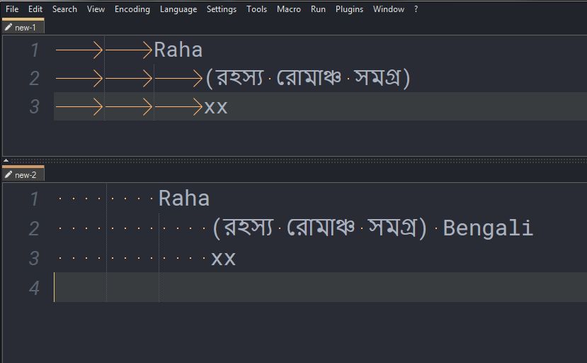

          • Randy Miller 0R
            Randy Miller 0 @Ekopalypse
            @ekopalypse
            Rahasya-Romancho Somogro - 2015 ss’s Bengali
            (রহস্য রোমাঞ্চ সমগ্র) Bengali
            (xx)
            This is a cut and paste of part of the text file. The cut and paste “fixed” the problem, in that the second line lines up vertically with the third line.
            The first line leads with 8 spaces.
            The second line (with Bengali script) leads with 12 spaces.
            The line with (xx) leads with 12 spaces.
            However in the original file the second line (with Bengali script), when displayed on the screen, still leads with 12 spaces, but the spaces are not as wide, which moves the display of the beginning of the second line (Bengali text) to before the beginning of the first line of text. A “show all symbols” shows the spaces as a solid line to the (রহস্য রোমাঞ্চ সমগ্র) text, while the first and second lines show separate dots for each space. It’s as if the characters (in the second line) were squished horizontally, like make pitch smaller.
            I have noticed that if I add one ASCII letter character (upper or lower case) in front of the Bengali text then the line becomes “unsquished” and is displayed properly. The parenthesis “(”, as the first character following the 12 spaces, does not undo the squishyness. Neither does adding a “?” or some other non-letter ASCII characters.
            I’m looking into how I can upload a phone pix of this part of the file.
            Randy Miller 0R 1 Reply Last reply Reply Quote 0
            • Randy Miller 0R
              Randy Miller 0 @Randy Miller 0
              @randy-miller-0
              The first line beginning with Raha has 8 spaces before it.
              The second line with Bengali text has 12 spaces before it, and should line up with the third line.
              The third with (xx) has 12 spaces before it.
              If I type a letter character on the second line, after the “(” but before the Bengali text, then the display of the beginning of the line suddenly shifts to being in line with the third line.

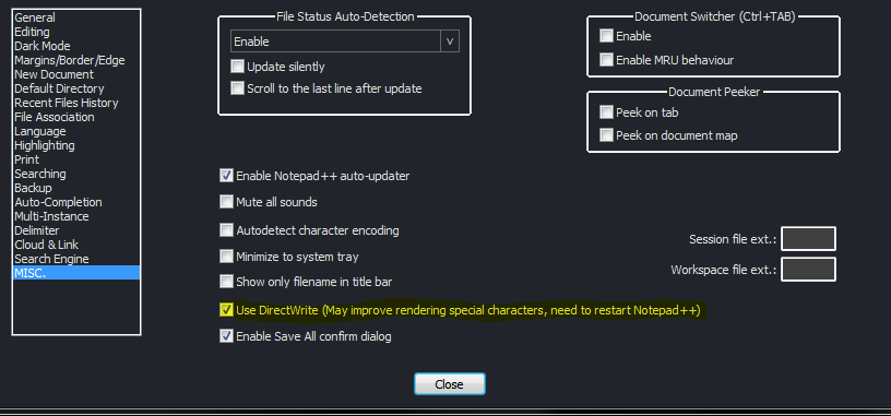

                Ekopalypse @Randy Miller 0
                @randy-miller-0
                Sounds strange and is no problem for me with utf8 encoded buffer and RobotoMono font.
                I would give it a try by enabling DirectWrite
                • Randy Miller 0R
                  Randy Miller 0
                  Thank you. Enabling DirectWrite fixed the problem.
