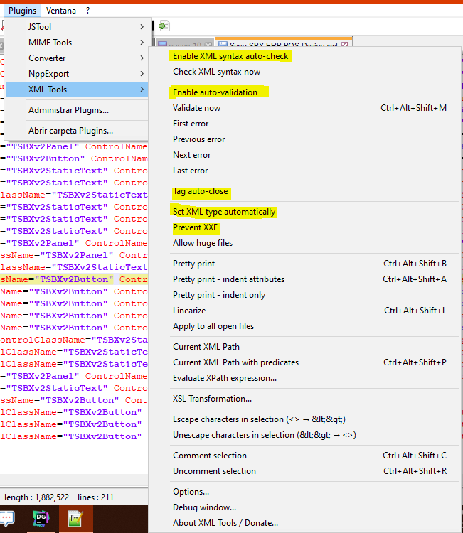

                                @luc-verhoeven Hello, i fixed s
                                disabling these options
                                now i can save all my XML faster i hope this works for you
                                ? NMC1992N 2 Replies Last reply Reply Quote 2
                                  A Former User @Joel Rodriguez
                                  @joel-rodriguez Thank you!
                                  This is what worked for me
                                  • NMC1992N
                                    NMC1992 @Joel Rodriguez
                                    @joel-rodriguez Thank you so much! I’ve been having this for a while, so a work-around is much appreciated! :)

                                      FYI, I just installed the July 15, 2022 build (v8.4.4) and the bug is back. Following the advice of @joel-rodriguez I was able to save my files without locking up.

                                        This happened to me on 8.4.7. Disabling the options mentioned by @joel-rodriguez worked for me
