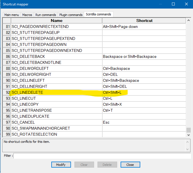

      I can’t believe there is really a hidden shortcut
      How is it hidden??
      It’s right in the Shortcut Mapper (get there via the Settings menu):
      Earth InvaderE 1 Reply Last reply Reply Quote 3
      • Earth InvaderE
        Earth Invader @Alan Kilborn
        @alan-kilborn Oh I don’t know what Scintilla means so I didn’t look at that tab. I through the shortcut is hidden because there is no entry under Main Menu > Edit > Line Operation. I guess regular people would try to find such shortcut there and if its not there, they probably think there is no such function implemented.

            Although @alan-kilborn is technically correct that those actions & shortcuts are not hidden, the larger truth is that they are so hard to find, they may as well be hidden:
            • not shown on any menu
            • not mentioned in the npp manual
            • in the Scintilla doc the action names (constants used by coders) are found in a list; no shortcuts given, actions not described
            So @earth-invader is surely correct in suggesting the natural place for them is Main Menu > Edit > Line Operation where they’d be seen, learned and enjoyed daily by the line-deleting (and line-cutting) masses.
            For a bunch of years of my using npp, Ctrl+L wasn’t in my repertoire, and how should I have known that it was available? Either by a motivated search thru Shortcut Mapper, or luck. I only learned about Ctrl+Shift+L when I was doing my response above (I wanted to check the “official” name of the Ctrl+L action). (And I’m happy to know about it because it happens often enough that after a Ctrl+L action I realize I unintentionally disturbed the clipboard.) (And it feels wonky that the 2-key combo is mapped to the more complex action, and the 3-key to simpler.)
            Other useful actions with shortcuts that are effectively hidden are: Line copy (Ctrl+Shift+X), and the lovely paragraph navigate & select actions (shortcuts w/square brackets), and (maybe a bit less useful) the word-oriented counterparts (shortcuts w/slashes).
            It’s a shame a user has to try discovering these by perusing a list of 99 rows of arcane and often only vaguely descriptive names. It doesn’t help that the list only appears in a modal dialog, so you have to dismiss it before you can play around with a shortcut that in the moment looks interesting, and… when you’re done fooling with that s/c, and you want to resume browsing for another, you need to do a bunch of clicks and careful scrolling to restore the view.
            And it gets better.
            The Shortcut Mapper lacks common features we expect with tables, like the ability to sort by specific column, and, ability to select between (a- & de-)scending. The filter feature is nice, but it’s hobbled on the Scintilla tab: in all the other tabs (i.e. Main menu, Macros, Run, Plugin) the Filter applies to the Shortcut column (in addition to the Name column) so you can helpfully filter with “ctrl+”, etc (would be even more helpful with ability to have filter apply only to Shortcut column). But, on the Scintilla tab the filter only applies to Name column.
            So, for reasons on top of reasons, the user manual and UI conspire to disincentivize user learning of handy shortcuts.
            The manual would be greatly improved by including this:
            A good way learn about many useful shortcuts (not documented in this manual) is to launch a new instance of npp, and in one instance, bring up the Scintilla tab of Shortcuts Mapper, and, in the other instance, try out shortcuts to see what they do.

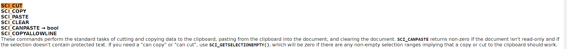

              The reason why we don’t individually docment the 99 or so Scintilla operations is because the Scintilla Project fully documents exactly what every one of those does at https://www.scintilla.org/ScintillaDoc.html. If you don’t think there is enough linkage in the documentation, the maybe creating an issue and/or PR would be useful. For example, if you had an issue and accompanying PR which suggested the wording in your example paragraph above, I would probably rephrase it some, add links to the Scintilla documentation, and probably approve it. And if that happened in the next couple days, it might even be in time to be included in the next update of the user manual website, which I will probably be telling Don that it’s ready for publishing soon, because it looks like v8.3.3 is pretty stable and might trigger auto-update soon.
              Of course no shortcuts are given in the Scintilla docs: the shortcuts are defined in Notepad++. And the Shortcut Mapper does a good job of showing what the current shortcuts are.
              And, in my opinion, the Scintilla documents do describe what many of them do. For example, the SCI_CUT and related are clearly described as being clipboard-related actions:
              However, you are right, your Ctrl+L SCI_LINECUT doesn’t have a good description in the scintilla docs Keyboard Commands section. Maybe you could suggest improvements to that section to Scintilla documentation team.
