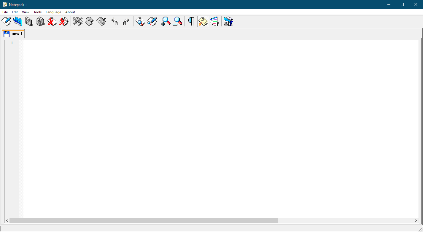

          Are you sure? I believe this is the case for all Windows applications, including Notepad++ all the way back to the beginning:
          Notice the underlines on F in ‘File’, E in 'Edit, V in View and T in Tools when I press the Alt key to get a screenshot (Alt+PrtScrn):

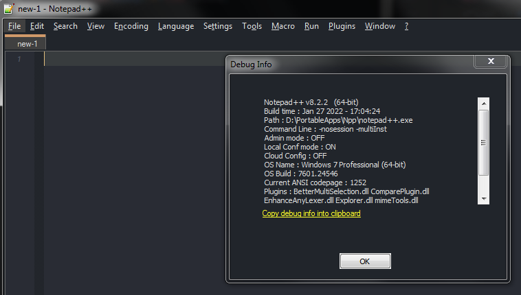

              I have the same behaviour on Windows 7 (my normal operating system) as on Windows 10 (running in a VM).

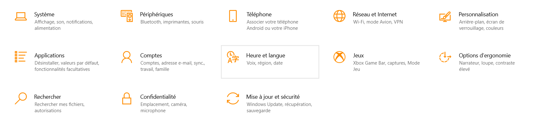

                Hello, @tim-pronin, @ekopalypse, @alan-kilborn and All,
                @ekopalypse :

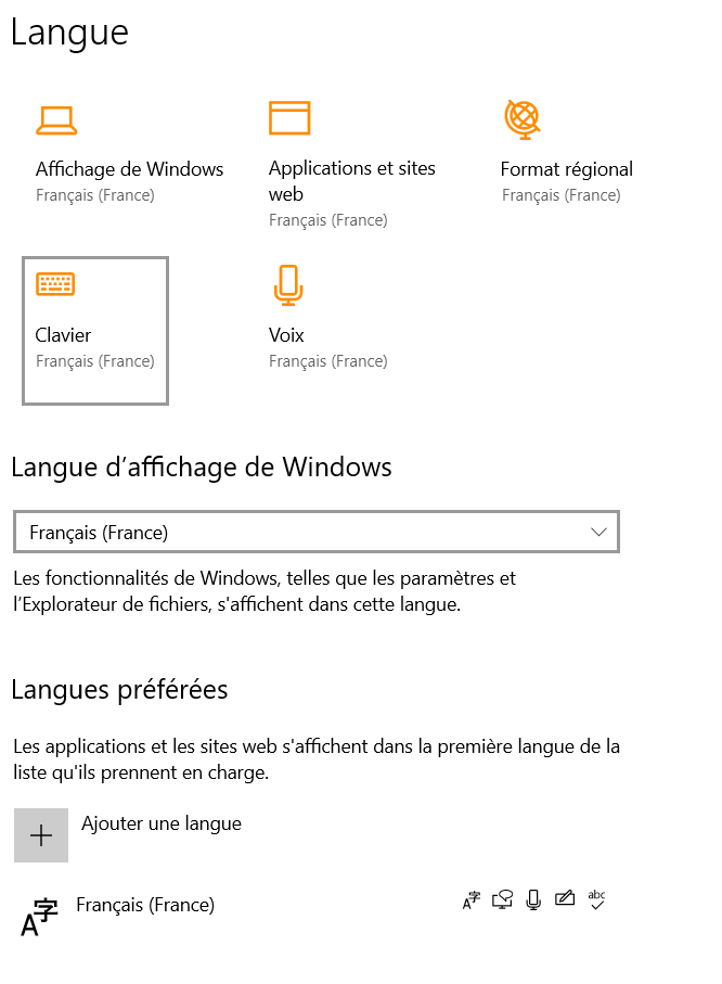

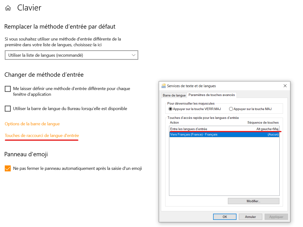

                Not totally sure But I suppose that Tim speak about the Windows default shortcut to switch betwenn two keyboard layouts, on the same laptop/desktop !
                Here are 3 screenshoots, from Parameters ( Sorry, but it’s all in French language )
