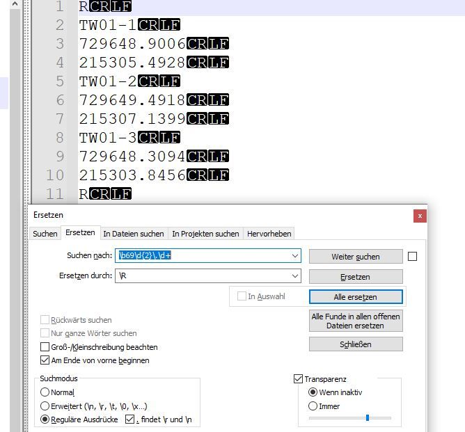

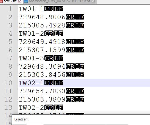

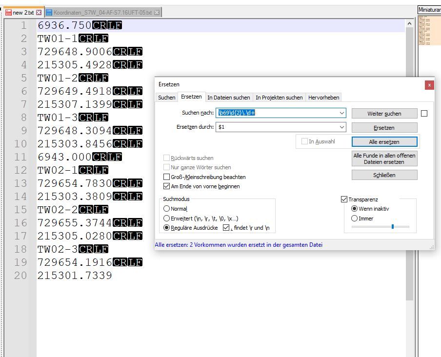

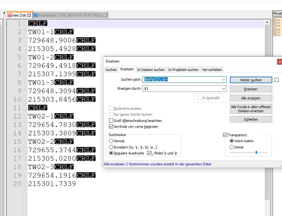

          thanks for your quick and helpful reply. The search method with … worked. But would like to search for the values and then automatically replace them with “delete row”.
          I can use the Replace = $1 command to delete the row contents, but the row still exists as CRLF. Do you have a solution how I can remove the row with a replace?
          Thanks

            • Thomas KlinghanT
              Thomas Klinghan @Alan Kilborn
              @alan-kilborn
              Okay, I get it. I added an \R to the replace field. I now search for \b69\d{2}\.\d+ and replace it with a \R. Unfortunately I don’t get the desired result. I would like to search for the lines that look for a value in the range of 6900 and delete this line.
              By replacing with \R I get only a R CRLF (see photo).
              In the end my text file should only consist of lines that contain the values in a range of values and no empty lines. (see photo)
              Unfortunately I can’t find a solution for this problem.
