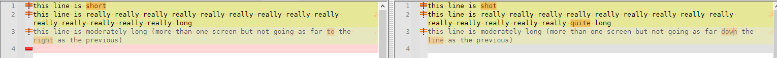

      I have two files open for compare.
      When I click at a position on a line, the screen jumps back to an earlier location on that line and thus I then have to go and find that location again and once again click in that location. Sometimes that is Ok, most time not.
      What I usually have to do is after the screen jumps backwards to an earlier position, I then have to move the cursor to the location I want to alter that text.
      Hope that makes sense.

        PeterJones @Krammig
        @krammig ,
        It might help you to turn on word wrap.
        When I have word wrap off, if I’m at quite on line#2 :
        and click on down on line#3, it scrolls the horizontal view left:
        I assume this is what you are annoyed by.
        If so, when I turn on word wrap, I can click back and forth between quite and down without any unexpected scrolling – because it all fits in one screen-width.
        KrammigK 1 Reply Last reply Reply Quote 6
        • KrammigK
          Krammig @PeterJones
          @peterjones Excellent, thanks for that Peter. That did the trick.
