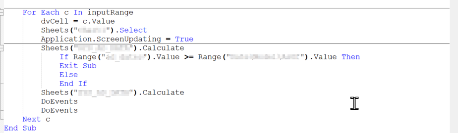

                              I was able to get lines via the recommended method, however they look like this (code snippet below).
                                PeterJones @DevSrc8
                                @devsrc8 said in VBA formatting with line after SUB's:
                                Yes, that is a drawback, because the LINEBEFORE_EXPANDED (and all the other fold flags) apply to all the code folding in the current language, like IF/THEN/ELSE and FOR loops, not just the function-level folding.
                                The feature you actually want doesn’t exist. You have to then decide which you would prefer: partial workaround that adds it in the right place but also in other places where you don’t, or no workaround which uses the default settings and other folding sections will still look right.
