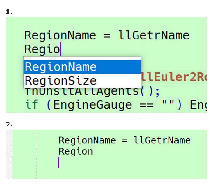

      After I updated to 8.3 I found that the autocomplete for the language I was using (LSL for Linden Script Language)) started bombing out. I’d enter keywords as usual (as per 1 below) but pressing ENTER to select an option just inserts a new line (as per 2 below).
      This was working fine before.

          Please take the time to read other posts on this and the release notes on Notepad++ 8.3.
          Open your Settings menu. Select Preferences, go to the Auto-Completion section and take the check box for enter.

            Thank you, that worked! I did try searching the community posts but this is the first time I’ve used it and got a bit lost. Thanks again.
