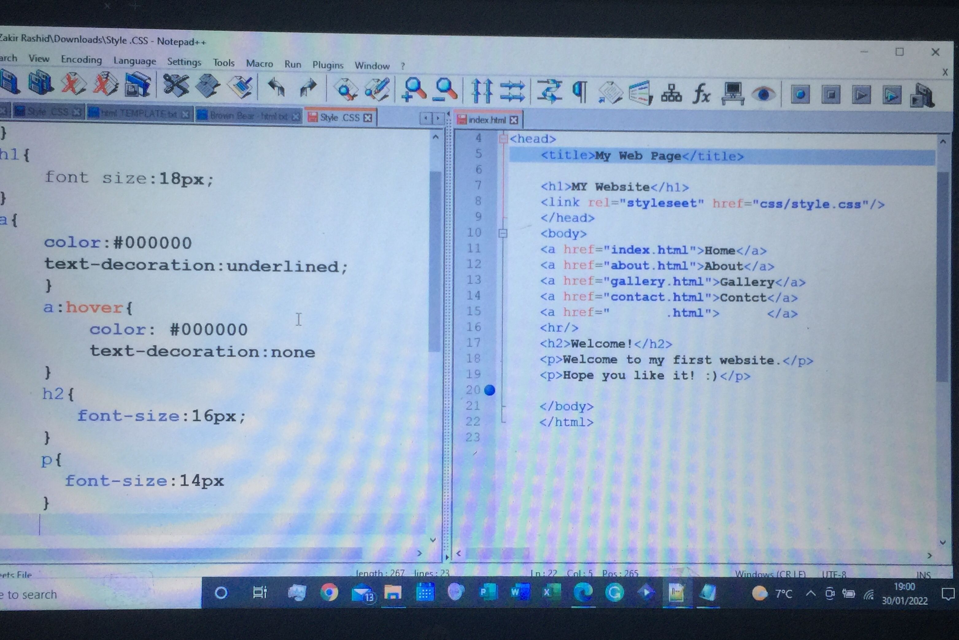

    • Khal RashidK Offline
      Khal Rashid
      Hi I am a beginner to coding, and having problems linking html files to css files and to see what the result would look like in my webpage.
      I would appreciate any pointers thank you for your assistance .
      Khalid 0F2BAA98-17C1-40BF-906B-E15CDA75A738.jpeg )

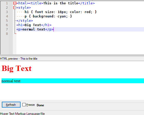

                                  PeterJones @Khal Rashid
                                  @khal-rashid said in Help wanted for beginner:
                                  I have been learning from w3shools, and they split screen,
                                  Thank you for clarifying.
                                  That’s not how Notepad++ does it – Notepad++ is a text editor, not a web browser, so it doesn’t have a built-in HTML render engine like a browser does.
                                  Your options are:
                                  1. Use the Right Click on the tab bar, select View in Default Application, which will launch the HTML in your default browser (this was already explained to you). Once you’ve done that, as you save changes in Notepad++, you can F5 refresh in the browser to get it to see the changes
                                  2. Use the View menu’s View Current File In… sub-menu, to choose whether to look at it in Chrome, Edge, Firefox, or the abomination IE. This is essentially the same as #1, but from a different menu, and allows you to select whichever browser you want.
                                  3. Use a plugin like PreviewHTML, which embeds an HTML “browser” (render engine) in a second panel, which you could put to the right to make it look like w3schools, or could put beneath to make it be able to be a wider panel.
                                  The third option is probably the closest to what you want.
                                  Example screenshot
                                  Khal RashidK 1 Reply Last reply Reply Quote 2
                                      @khal-rashid ,
                                      Pick IE11 – there is no reason in the 2020s to choose anything below that. (Really, the plugin author should switch to using the calls to get an Edge-based rendering rather than IE-based rendering, but I doubt that will happen.)
                                      Then, to get the preview, click Preview HTML from the menu you showed (or hit the Ctrl+Shift+H keyboard shortcut that menu shows):
                                      which will then show something like what i showed above, or, if your panel is on the right, like:
                                      The View As menu entries are a setting-change. The Preview HTML (Ctrl+Shift+H) entry is what actually shows the panel.
                                      Khal RashidK 1 Reply Last reply Reply Quote 1
