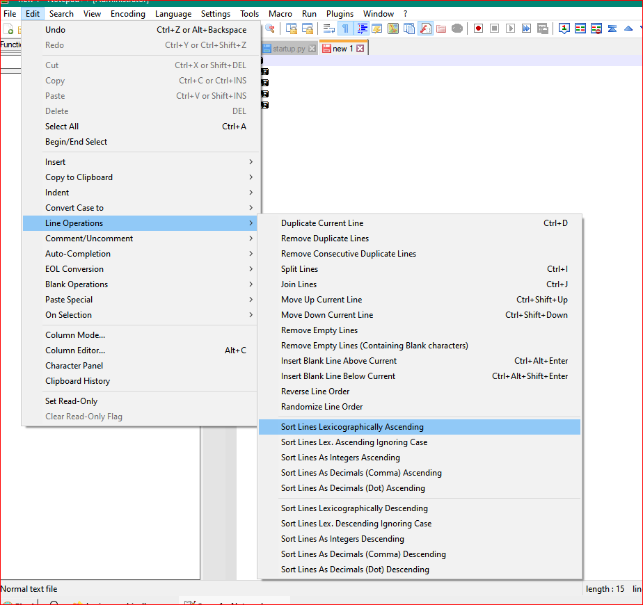

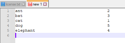

        The same way you’s sort the word list. Using your list of numbers, I just sorted it Lexicographically Ascending as the screenshots show.
        Using the Edit Menu:
        And Viola:

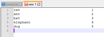

            @amazon-books You can insert a column of ascending numbers to the right of your text. See Edit|Column Editor.
            After sorting, you can use column select (Alt-mouse, or Alt-Shift-arrows) and cut, and perhaps Edit|Blank Operations|Trim Trailing to clean up.

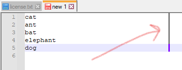

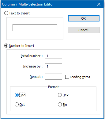

              Hold Alt while left-clicking on the first line, in the whitespace out to the far right (in a column number greater than the length of the longest line you are going to sort), and then drag down in the same column, to get a “selection” that looks like this:

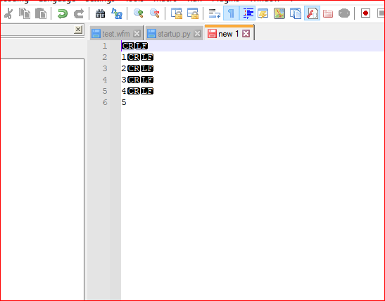

              Press Alt+c and set up the box that appears like this:
              Press OK and your data will be transformed like this:

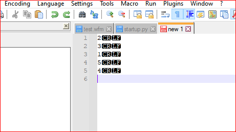

              Do your sort to obtain:
              Amazon BooksA 1 Reply Last reply Reply Quote 3
