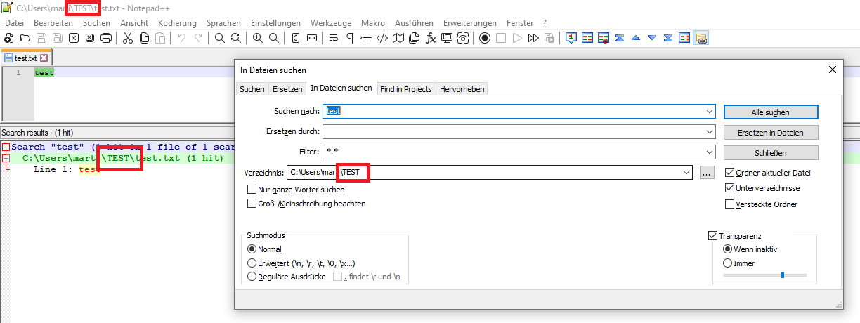

      I try it in Version 8.2:
      If I enter a directory manually with “Browse in files” without paying attention to the effective capitalization, I can open a found file with a double-click. The file will be opened under my entered path. The path I entered will be used instead of the case-sensitive effective path. Basically no problem, but for example the NppFTP plugin cannot save the file on my FTP-Server because the incorrect upper and lower case letters. Therefore, when opening a file, it should not use my entered path, but the effective path of the file.
      The effective existing path ist C:\Users\marti\test. C:\Users\marti\TEST doesn’t exist.

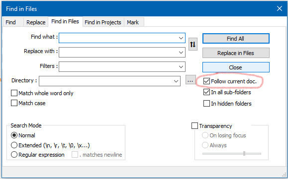

        I see that you have Follow current doc. ticked:
        With that ticked, when you are editing (in the active editing pane’s tab) and you initiate Find in Files (with Ctrl+Shift+f, say), then the Directory box contents get overwritten with that path of the active file.
        But… sometimes one leaves the Find in Files window open and works with several tabs in different paths. In that case, to refresh the Directory box, untick Follow current doc. and then re-tick it. The currently active file’s path will then be put there.
        Unless there’s more to the problem, I’d think that would solve it.

            My use case is that I never type INTO the Directory box. I always have Follow current doc. ticked for automatic entry, and for any other use I’m pasting data into the Directory box that was copied from another source.
            The moral of that story is that you really can’t get a path wrong with those methods.

              I only discovered the “error” because, exceptionally, I wrote in the field myself. I believe that a file should be opened with the real path and not with a path I typed. That a file is found despite my “wrong path” is actually nice.

                    or @Martin-Oberhänsli should stop manually typing the path, and just use “follow current directory” (as @Alan-Kilborn already suggested) or the ... directory chooser or RightClick > Current Dir Path to Clipboard then paste the path into the Directory field – any of which would always get the right case for the directory.
