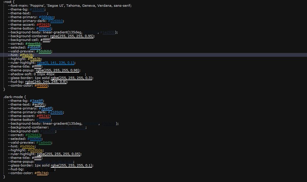

      I apologize in advance if this question has already been asked. Here is my proposal.
      Since N ++ is used by most people for programming or quickly creating such files, it would be convenient to implement RGB, HEX, HSL color previews. I’m sitting here editing colors.xml for a decompiled apk and I don’t understand what HEX I’m entering (I have over 100 lines with HEX values). Unlike plugins, it has to work on the fly. An example of this behavior is given using the plugin for Atom (an example will be below as an animated image.). At the same time, an editor is not required at all - the most common preview will be enough for work.
      Example realize from Atom

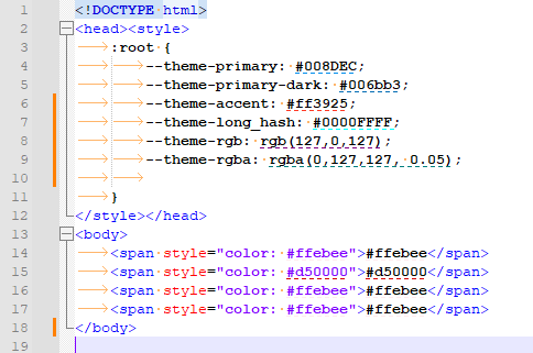

                  @michael-vincent, these 20% are exactly what I need. Take a look at this image:
                  What do you see? That’s right, in a free line it still recognizes its fill, but what’s wrong with the value that is inside the tag? I’m sorry, but why should I define a color but not define it in the right place? In this case, what’s the point of a HEX value if it’s not inside a container? With such success, Apktool will simply give me an error for my illiteracy.
                  Why I gave an example from plugins in Atom - even if the syntax is completely broken, but the color value is entered correctly - it will grab it. And here it turns out it will only work in some places. You are not the developer of this QCP, but as in my case, this plugin is simply useless if it cannot do the job. If you don’t have any other ideas, then perhaps we should close this question if it doesn’t crown a successful solution. Thanks for answering.
                  I used Google Translate, so please ignore any errors.

                      PeterJones @ThIsLinked
                      @thislinked said in Preview value color RGB, HEX, HSL.:
                      Apparently, the QCP doesn’t recognize < as ending a color hex sequence. It does recognize a space or a " or a ; as valid character to come after the hex. And it doesn’t recognize an 8-nibble HEX as a valid RGB color.
                      I wouldn’t call that useless. Just something that could be improved.
                      This isn’t a Question and Answer board where we “close questions”. This is a Community Forum, where we are here to discuss things.

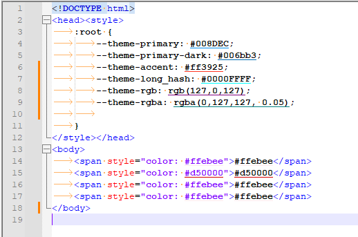

                        Interesting. My ColorizeHtmlCssColors script isn’t picking up on the ones in the style tags, but does pick up the examples like you showed. (Also, it only does #RRGGBB, not rgb(…) or #AARRGGBB)
                        I hadn’t used my script in months (I don’t actually deal with color terms in my normal workflow), so I’d forgotten: you run it once to colorize, and another to remove the colors. But what I did remember, but probably didn’t make clear, is that if you edit a color text after running, it doesn’t update on the fly, so you then have to uncolor and recolor to get it to update.
                          Michael Vincent @PeterJones
                          @peterjones said in Preview value color RGB, HEX, HSL.:
                          @ThIsLinked
                          It does now …

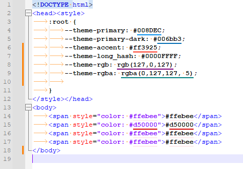

                            Actually, it was, but Notepad++'s lexer coloring for being an attribute was overriding my scripts indicator. If I switch to normal text (so no lexer is active), it shows the color even inside the attribute:
                            I am working on updating my script: it now allows #AARRGGBB as well. Eventually, as I find time, I might also add in the rgb(_,_,_) syntax as well, but I’ve got a meeting in a few minutes, so not right away.
                              PeterJones @Michael Vincent
                              @michael-vincent said in Preview value color RGB, HEX, HSL.:
                              It does now …
                              I did confirm:
                              So it’s working better than my script again, since it works even with a lexer active, and accepts other endings. :-)
                                Updated the github copy of the script again…
                                Using dash rather than foreground. allow rgb(##,##,##) to work
