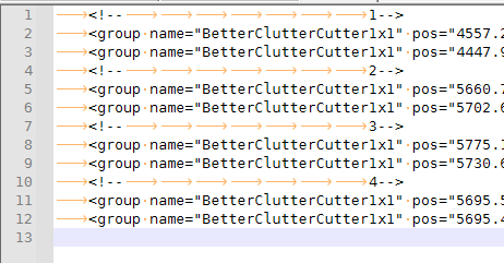

        However, if you really have the <!-- --> comment lines every third line, as shown in your example, I would do the following:
        1. FIND = \R(?!\h*<!--), REPLACE = ☺, SEARCH MODE = Regular Expression
          • This will condense each group of 3 lines into one long line.
          • I picked ☺ because that’s not likely in your document already, and it will make the final step really easy
        2. If the first line is really indented differently than the others, as you’ve shown, then you will want to indent the first line to match.

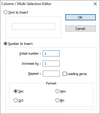

        3. Use Alt+drag next to the --> on each line to “column select”:
        4. Edit > Column Editor, click ⦿ Number to Insert, Initial Number = 1, Increase By = 1, OK
        5. FIND = ☺, REPLACE = \r\n, SEARCH MODE = Regular Expression
