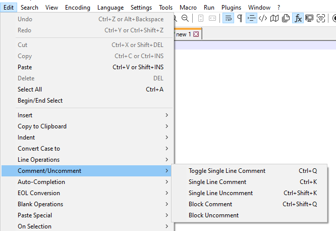

                  Because, as @ArkadiuszMichalski already said, the commentLine, commentStart, and commentEnd attributes in the langs.xml are only used by the “toggle line/block comments” – which means for the Edit > Comment/Uncomment menu actions:
                  The syntax highlighting is handled by a library of compiled C++ “lexer” code inside Notepad++; the lexer for C/C++ knows that /* ... */ is a block comment and // is a line comment; the lexer for LISP believes that #|comment|# is the block-comment syntax for LISP. The LISP lexer does not look at the XML attributes mentioned above when deciding what is and is not a comment, and you cannot change what the lexer considers a comment by changing those attributes in the langs.xml config file.
