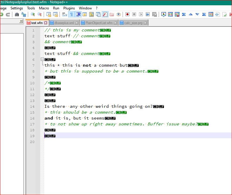

      I have to attribute this to the buffer being redrawn. I played a bit, got pictures and a better understanding of what might be going on here. This shows the text, just written behind an asterisk comment at beginning of line:

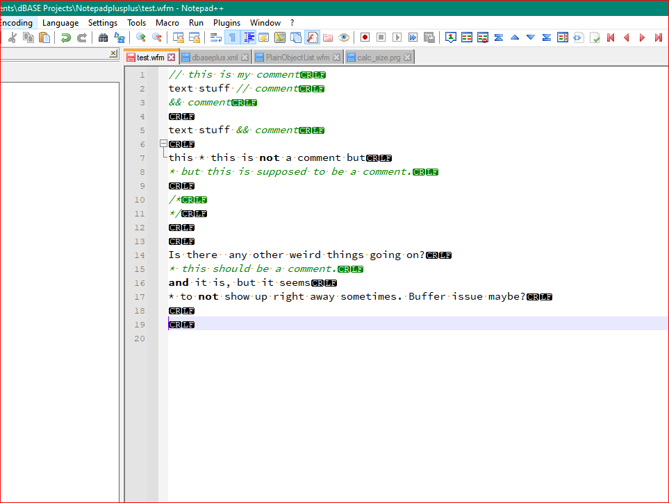

      This shows it freshly typed, several cr/lf characters after without the screen redrawing. When I click the tab of another file and then come back, without it being saved, it shows this:
      All working nicely like it’s supposed to. So I thought, oh it’s stil having a problem with the operators colliding, so earlier I figured out while looking at the text this should be a comment. I spent timea in the UDL Define your language dialog box clicking a change in the operator box color, font, whatever, and watched as the line comment changed back and forth with the change of the operator box.
