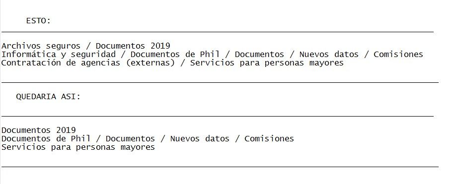

      Hola,
      quisiera conseguir eliminar todo lo anterior a la aparición de la primera barra de cada línea, con la posibilidad de eliminar la barra o no eliminarla.
      P.ej: ¿cómo eliminar todo lo anterior a la aparición de la primera barra barra.jpg
      Agradeceria ayuda
      Disculpen si es una pregunta absurda, soy nuevo en esto.
      Gracias de antemano.

        Try:
        find: (?-s)^.*?/\h*
        replace: nothing
        mode: regular expression
        jesus ulJ 1 Reply Last reply Reply Quote 0

          It’s a simple task for RegEx. Open the Replace dialog (Ctrl + H) and type:
          Search: (?-s)^([^/]*? / )(.+?)$
          Replace: $2
          Put the caret at the very beginning of the document, select the Regular Expression mode and click on Replace or Replace All.
          Now, if you want to preserve the first bar, try this other regex, following the above-mentioned instructions:
          Search: (?-s)^([^/]*? (?=/ ))(.+?)$
          Replace: $2
          Notes: Next time, please make postings in English —if inconvenient, translate it with a service like deepl.com . Also, please follow the template for search and replace questions.

            jesus ul @astrosofista
            @astrosofista Hello astrosofista,
            thanks for the answer, it’s just what I was looking for, and thanks for your recommendations. I’m new to this community and I don’t know the dynamics of this forum well yet, I’ll do my best.Thanks again.
            • jesus ulJ Offline
              jesus ul @Alan Kilborn
              @alan-kilborn Hello ,
              thanks for the answer, but it is not what I was looking for.
              I will explain it more graphically:
              thanks again:¿cómo eliminar todo lo anterior a la aparición de la primera barra barra.jpg
              Paul WormerP Alan KilbornA 2 Replies Last reply Reply Quote 0

                @jesus-ul
                You probably did a “replace all”. The regexp is designed to go line for line. Place the caret (cursor) on top of your file and hit “Find Next”. You see a string marked from the start of the first line containing a bar up to the first bar (grey background). You may replace the marked string by “nothing”. If you then hit “Find Next” you will see the first string on the next line marked up to the first bar. You can replace this again by “nothing”, and so on to the end of file.
                jesus ulJ 2 Replies Last reply Reply Quote 0

                      Alan Kilborn @jesus ul
                      @jesus-ul said in En cada linea, ¿cómo eliminar todo lo anterior a la aparición de la primera barra?:
                      Ah, my answer fell victim to the “where does the next search start” problem in Notepad++. Most editors would do it with my expression and give you what you wanted. :-(
