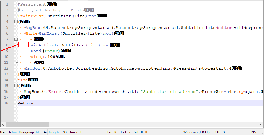

      Hi, does anyone know how to replace/remove this double-spaced-dot character?
      A single dot is a space, but this one is a double-spaced-one. Does someone know what this character is?
      Thx
        PeterJones @Focuscar A.
        @focuscar-a ,
        Are you sure there’s really only two characters (space and weird)? I would think there are three: space, weird, and another normal space. (Might be as simple as a non-breaking space between; might be one of the more complicated invisible characters.)
        But either way, you can just select and copy the character(s) and paste them into the FIND/REPLACE dialog.
        Or maybe you’ve got a plugin that’s doing unexpected thing to the visuals of spaces. Or maybe your font is not a monospace font, so it’s not giving equal width to every character.
        There are also PythonScript-based scripts that have been published on the forum that can give a “representation” (similar to the CR and LF boxes) to the invisible characters – searching for zwnj should get you those; or my GetUniChar.py which will use the statusbar to show you the unicode codepoint for the char to the right of the cursor.

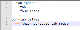

            PeterJones @Robert Carnegie
            @robert-carnegie said in Replace unknown character:
            Shooting from the hip, isn’t that tab marks?
            No, it isn’t. If View > Show Symbol > Show Whitespace and TAB or > Show All Characters is enabled (the latter is what it must be, because of the orange dots for the spaces that @Focuscar-A showed, along with the black CR and LF boxes at the end of line), then tabs use stretchy arrows in their display, as shown below.
            The dots in my screenshot are spaces, the arrows in my screenshot are tabs, and the long blank between the dots that @Focuscar-A showed is either another character or some weird spacing issue, not a tab.
