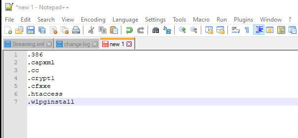

      Hi Everyone,
      Need your help. This is what i am trying to accomplish. I have this data that looks like this .dxy and need it look like (^.\.dxy$)| So my problem is the $)| will not come through i can make the (^.\ come through find with using the Edit>Column Editor. But not the end of it. Even if i use column Editor it does not work because not all the data are 3 characters. Some are 4 some are 3 or 4. I try Search>Replace and it will enter $ but not the closing bracket. Any advice how to overcome this. I am new to this so i am learning.

          yes, I am building up regex syntax. As i noted i am learning it. I am new to it. i am going to test it now. That’s where i was trying to accomplish it but i kept failing miserably on the last part of it $)| I could not make it stick on the end of the line.

            This is what I have my couple ones from many more. Thank you. Now i know something. Still learning regular expression. And knowing what each means.
