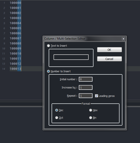

        Duplicate the row as often as you like and use the “column editor” to replace the 0000 with increasing values.
        The easiest way is to record a macro for a duplication and play it back as many times as necessary,
        Then put the caret in the first line before the 4th 0 from the right, for example
        af_10|0000_lead_box = 0.000001 ( | should be the caret ) and
        scroll to the last line, hold shift+alt and click on the last 0, which should look something like this.
        Call ColumnEditor and let the values change.
        It is IMPORTANT that you only select as many places as you actually want to replace.
        The example only selects two because I only replace two digits, otherwise the rest of the zeros would be cut off. Play with it and you will see what I mean.

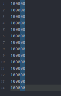

          @ekopalypse Thank you. Macro worked great, but I can´t get the step with the caret to work. This is what I get when I shift+alt:
          https://imgur.com/a/n1Vek0Z
          What am I doing wrong?
          EDIT: Maybe a version difference, I can mark the 00 with my mouse and then click alt+shift on the last line I want it applied to, that works fine then
            Ekopalypse @Cirlot123456
            @cirlot123456
            It looks like you held down the shift key while selecting, if that is the case, no,
            • click on the start position and release all keys
            • scroll down to the last line and then press Shift+Alt and click the mouse on the last position to be selected.
            Btw … there is no need to use services like imgur anymore, you can just paste the image from clipboard into the post.
