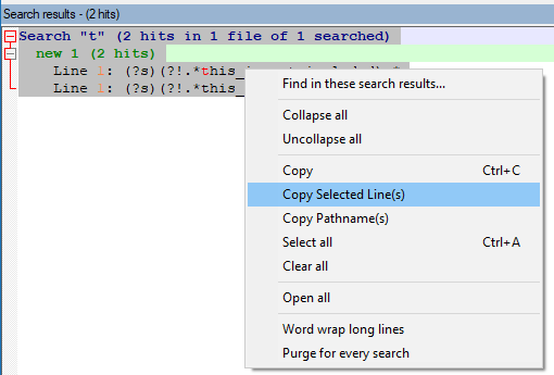

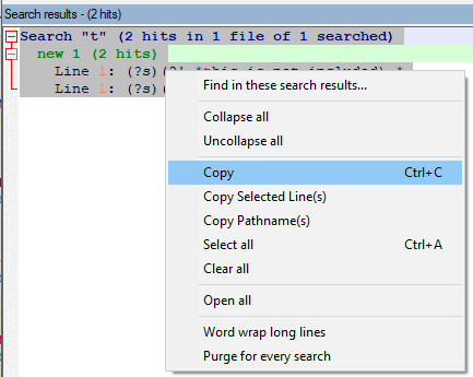

                            Alan Kilborn @Neil Schipper
                            @neil-schipper said in Regex: Show the string result from searching ALL FILES, between 2 parts:
                            copy text from Search Results (pane or window) into this new file.
                            There are 2 ways to do this, depending on whether or not you need information about the files to carry over in the copy.
                            This method will get you the search/file/line info along with the lines-of-match:
                            will get:
                            Search "t" (2 hits in 1 file of 1 searched)
                              new 1 (2 hits)
                            	Line 1: (?s)(?!.*this_is_not_included).*
                            This method will get you only the line data of the match:
                            will get:
                            Note that in the second example, since there are 2 results but the matched lines are the same line, only ONE copy of the line data is put into the clipboard.
