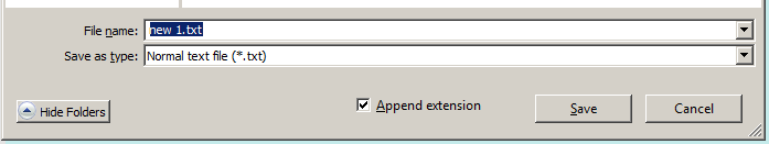

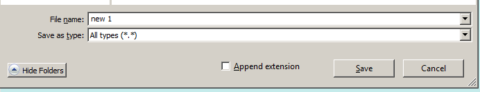

        using save on a random ‘new’ file (no extension provided):
        after ticking the Append extension box:
        Note: after ticking the ‘Append extension’ box a scrollable list of other options is available by selecting the down arrow head at the far right of the Save as type: field.
          Alan Kilborn @artie-finkelstein
          @artie-finkelstein
          I notice that if Append extension is ticked when the dialog box is invoked, unticking it will not remove the .txt extension from new 1.txt in the File name box. Thus, it must be removed manually – not a big deal IMO, because the new1 part is going to need to be altered anyway – before hitting Save. But some users may complain that this is a big annoyance.
          The Append extension checkbox has a “memory” so the next save of this type will be invoked with the checkbox unticked and only new 2 (for example) will appear in the File name box.
