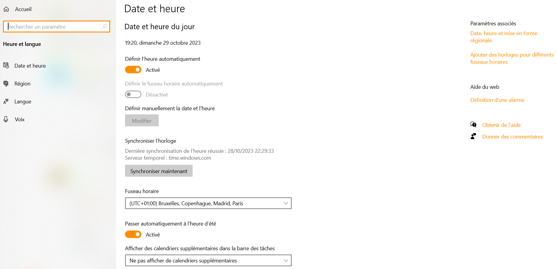

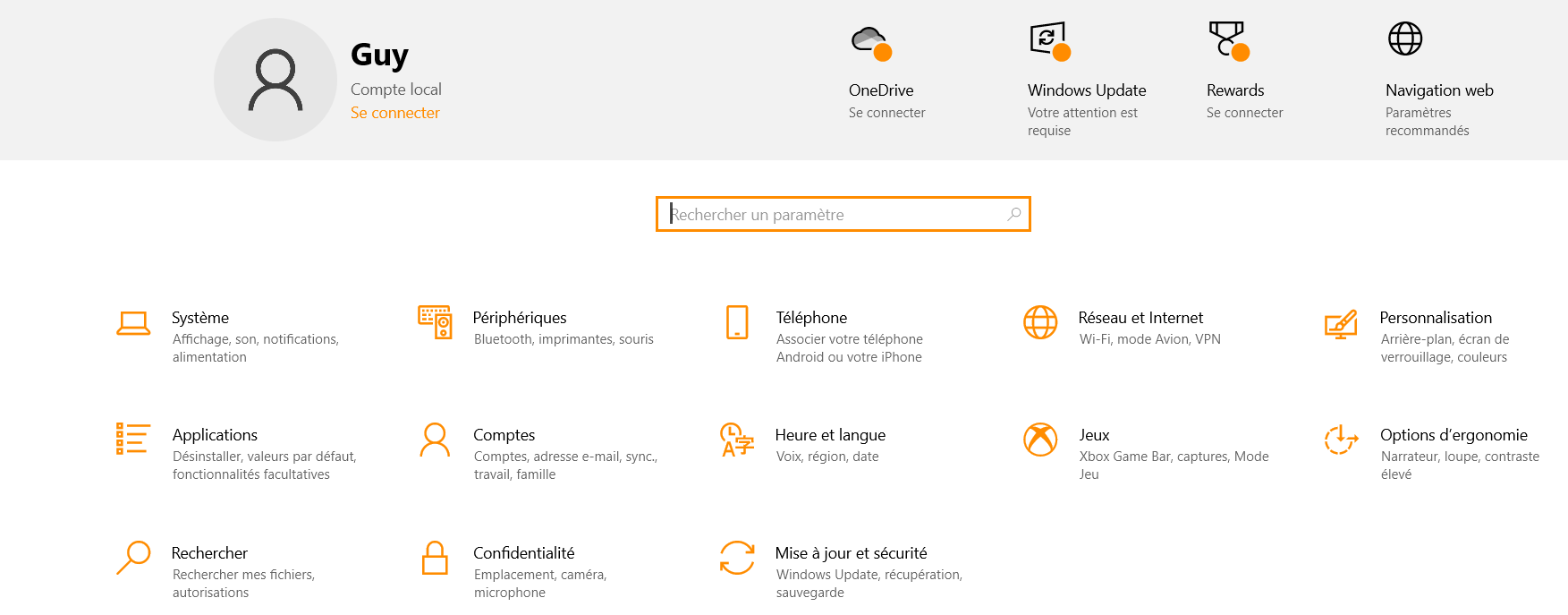

                        When I open the Settings window, I can go to the Heure et langue section ( which seems identical to the first choice Time & Language )
                        But, at this point, I’m quite lost :

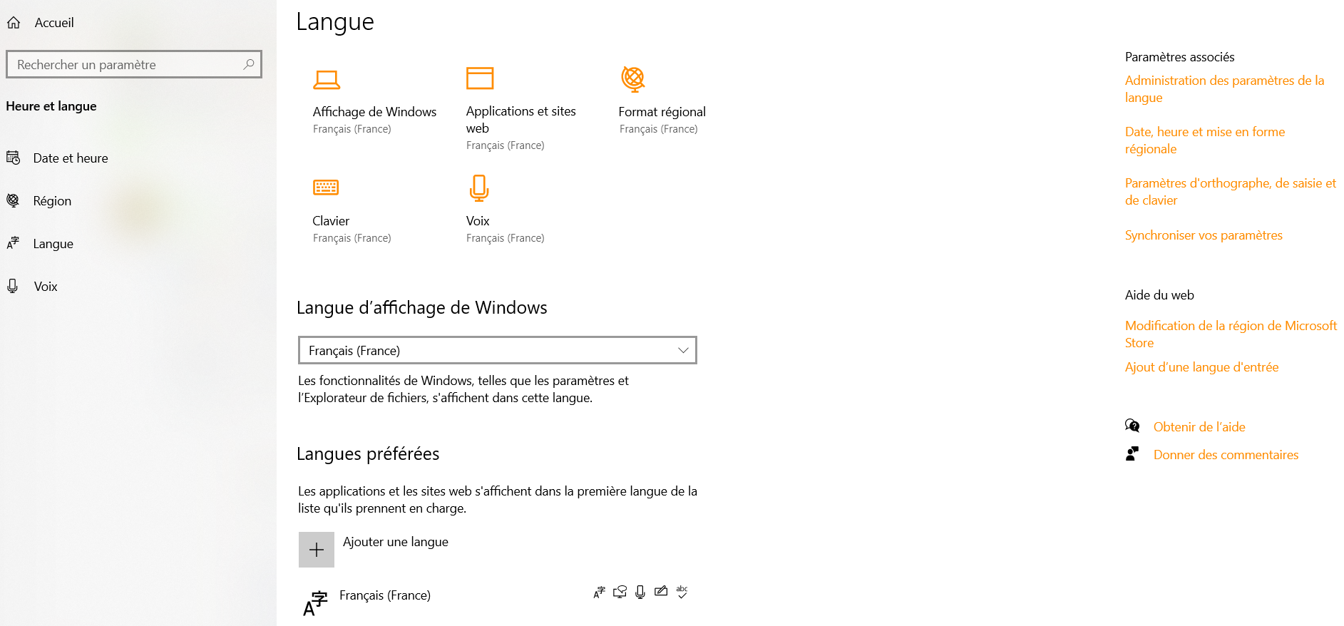

                        I personally see this screen, below. But, seemingly, you see a Language & region option, on the left side :
                        I suspect that it’s because, in the language part, below, I just have one language installed ( Français 'France ) and you probably have more than one installed in your Windows 11 installation ?
                        On the other hand, as I do not have any shortcut to switch between two Input languages, it should not interfere with Notepad++ at all and I should be able to use the cttl + Shift+ 0 shortcut !
                        Thus, Alan, could you show us, by screenshots, the first steps to do ?

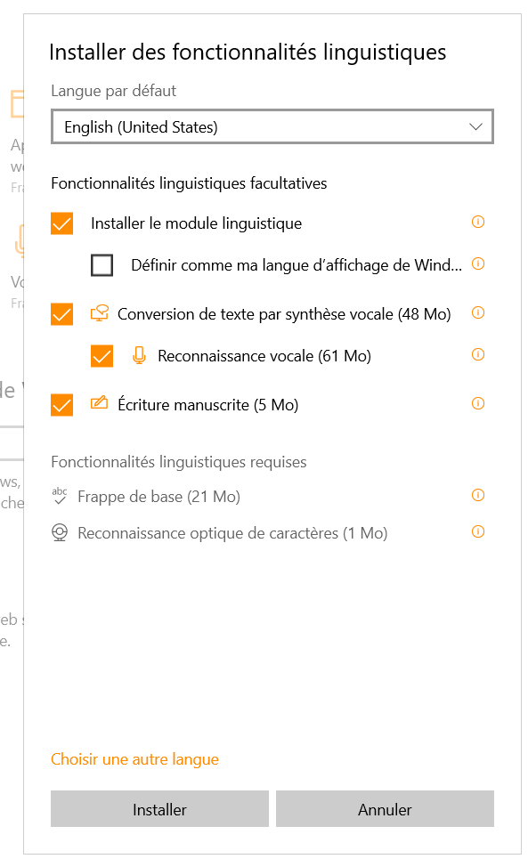

                        May be, I’ll neeed to install the English (United States) language to get options similar to yours ! However, it seems paradoxal to install something… in order to suppress an unwanted behaviour !

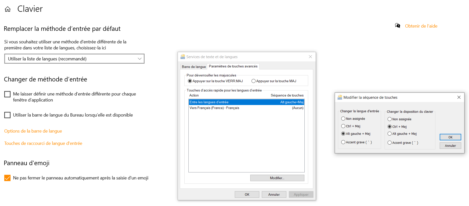

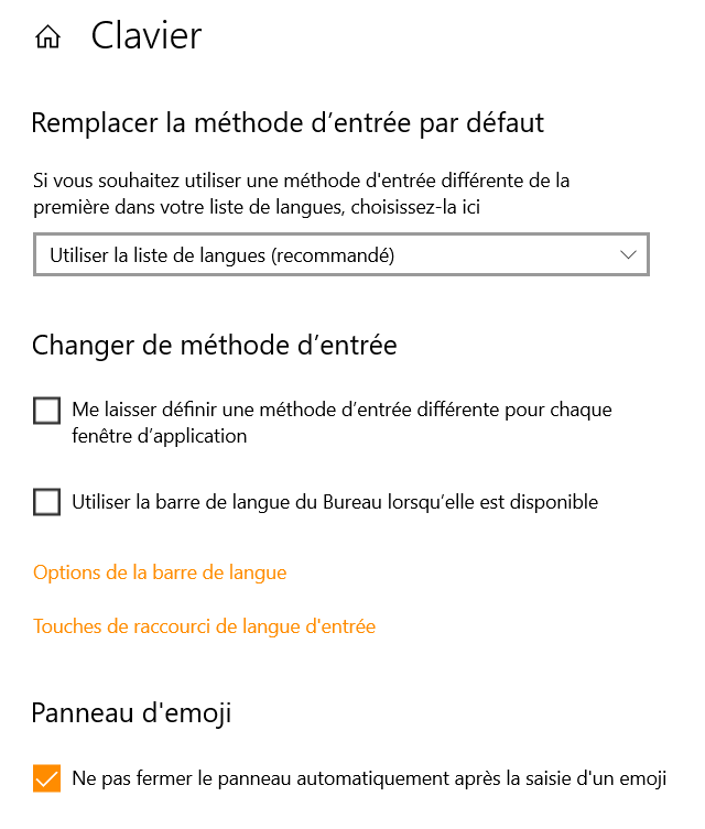

                          @guy038 Try clicking the “Clavier” icon that’s in your last screenshot. The dialog that raises should have a link labeled something that translates to “Input language hot keys.”
                          If that doesn’t explain it — is the key above and just to the left of P on your keyboard à — requiring Shift to produce 0? If so, it’s possible that the way Notepad++ is reading the keystrokes to produce an accelerator is seeing Ctrl[+Shift]+`a instead of Ctrl[+Shift]+0. I haven’t yet looked at the code to see if I can tell if that would be so.

                            Hello, @alan-kilborn, @coises and All,
                            Yes, @coises, you were right about it ! When I clicked on the clavier icon, I got this screen :
                            However, ( I cannot be sure ) it seems that, before, I did hit that icon and that I did not see the two options :
                            • Options de la barre de langue
                            • Touche de raccourci de langue d'entrée

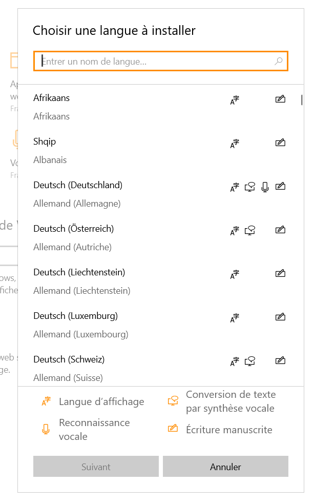

                            I must add that, at one moment, I tried to see what happens when you click on the Ajouter une langue option ( Refer the end of my previous post ) Well, you get this new screen and after choosing the Anglais (United States) option, I finally see this screen about installing this new language, that I DID NOT confirm ! May be, this abortive action was enough to enable the two options above ?
                            Anyway, after clicking on the Touche de raccourci de langue d'entrée I saw this window and after clicking on the Modifier... button, this small window appeared. As I seemed concerned with the Changer la disposition du clavier, I simply chose the Non assigned option, ( instead of Ctrl + Maj option and valid all the windows.
                            After restarting N++, everything was OK ! The funny thing is that I tried to put back the Ctrl + Maj option, for the keyboard layout, and, surprise, everything was still OK ??? I even stop and restart my laptop and it still worked fine !
