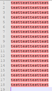

      Is it practical to remove “white” areas between marked data on adjacent lines?
      Example: I’d like the red coloring to “flow together” without a white gap, line-to-line in the following:
      I’ve experimented with Scintilla’s SCI_SETEXTRAASCENT and SCI_SETEXTRADESCENT, but they don’t seem to be the right things for this desire…

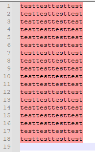

                  Then I get the effect I’m after:
                  Note that 31 is the indicator number for red-marking, and 16 is the value for INDIC_FULLBOX.
