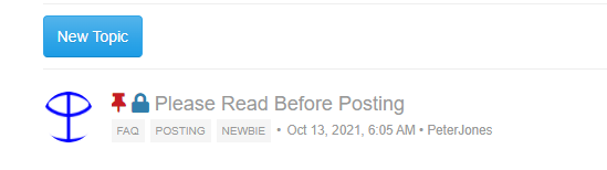

        Please note that your examples sometimes had " and sometimes had “ – those are two different characters. If you had followed the advice given in “Please Read Before Posting” (which you should have seen immediately below the New Topic button that you clicked):
        and the advice it links to in the “Template for Search/Replace Questions” and “Forum Formatting Posts” FAQ entries, you would have been instructed how to present your question in a way that left no ambiguity as to which was the “right” quote characters for your data.
