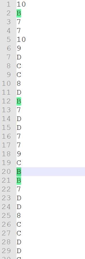

      hi, im kind of new noob user can you help me with this? i will try to explain,
      first im taking first 10 lines (1 to 10) and counting how many 7s,10s,Bs…in there and after that i try to find another 10 lines that have the same number of 7s,10s,Bs… with random order , so how can i do it?

            thank you guys , i wasn’t sure about this , i guess that this can be done with regex but it is complicated for example :
            if we have 3 lines :
            10
            7
            B
            so we have to calculate the possibility of the orders which is 3!=3x2x1=6
            and the 6 possibilities are:
            107B,10B7,710B,7B10,B710,B107
            now that can be translated to regex i guess like this:
            1[^\n]\n2[^\n]\n3|
            1[^\n]\n3[^\n]\n2|
            2[^\n]\n1[^\n]\n3|
            2[^\n]\n3[^\n]\n1|
            3[^\n]\n2[^\n]\n1|
            3[^\n]\n1[^\n]\n2
            the problem is with 10 lines there is 10! which is big number im looking for a way to make this simpler is that possible?
