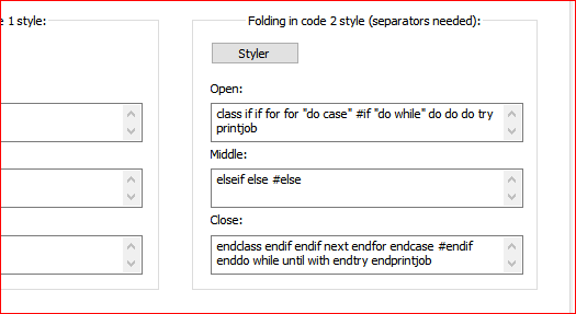

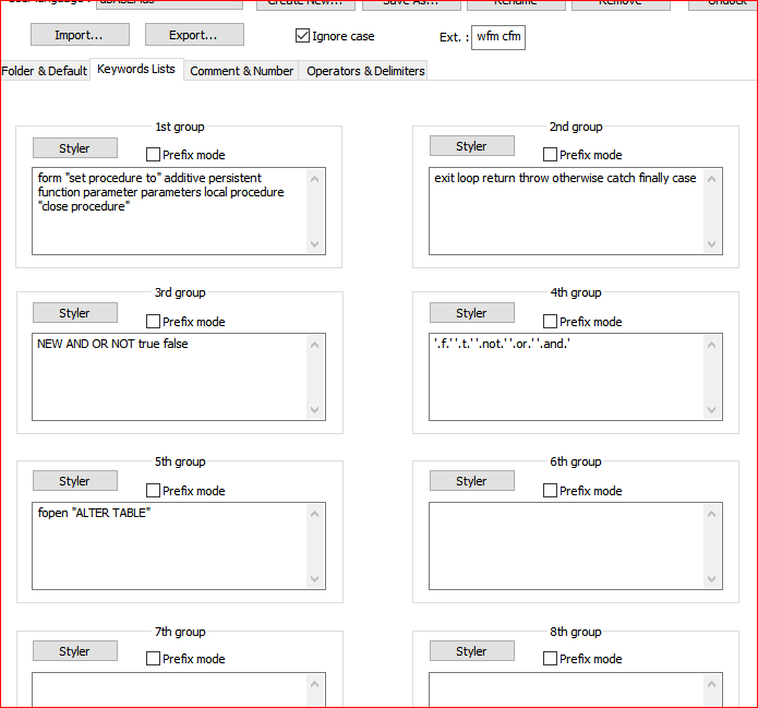

@dennis-bareis , both actually (single and double) as the below screenshots show, in both the open/close lists and the Keyword tab. If one doesn’t work, try the other is the best I can suggest. :-) Good luck.
Lee
