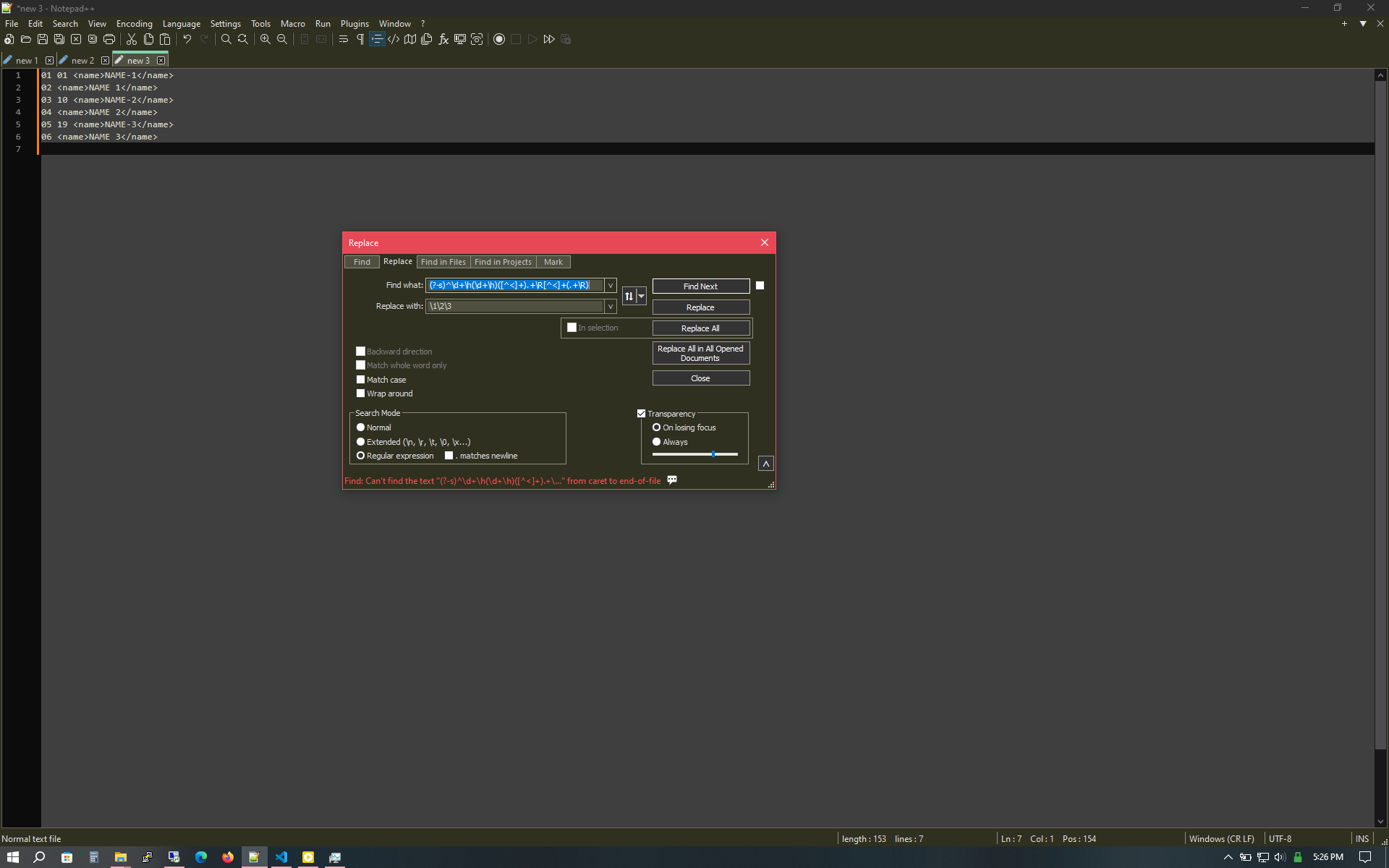

                        I’m trying to adapt this to my own use case. However, I ran into the issue with:
                        @Terry-R said in Replace bookmarked lines from one file to bookmarked lines in another file.:
                        Find What:(?-s)^\d+\h(\d+\h)([^<]+).+\R[^<]+(.+\R)
                        I tried Replace All as suggested, but it didn’t have the desired effect. Then I tried Find Next just see if the regex could find anything, but it gave an error as shown in the attached image.
                        Thanks,

                            Hi,
                            Fair point about not being an error.
                            I copied then pasted (regex) exactly from your instruction. Should it have worked? Because it doesn’t look like it.
                            Thanks,

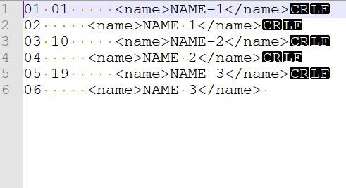

                                I’m trying to figure out why the regex worked for the OP and not for me. The data and regex are both from the screenshot.
                                Here is the data in text format (I copied from Notepad++ as also shown from the screenshot):
                                01 01 <name>NAME-1</name>
                                02 <name>NAME 1</name>
                                03 10 <name>NAME-2</name>
                                04 <name>NAME 2</name>
                                05 19 <name>NAME-3</name>
                                06 <name>NAME 3</name>
                                Here are the regex (copied/pasted directly from the instruction and also as shown on the screenshot:
                                Replace With:\1\2\3
                                Before adapting to my own use case, I’d like to gain a better understanding, so I’m replicating the given example/instruction step by step. Then I ran into the issue with the regex.
                                Thanks,
                                  Terry R @LarLei
                                  @LarLei said in Replace bookmarked lines from one file to bookmarked lines in another file.:
                                  Well, the data you show above isn’t exactly as per the screen shot. There are additional spaces behind the 2nd number on 1st, 3rd and 5th lines. The data of yours above doesn’t have those additional spaces.
                                  However I think I can see where it goes wrong for you as those spaces I accounted for, but not for a lack of additional spaces. Try adding a ? behind the first ([^<]+), so making it ([^<]+)?.
                                  As I said, a solution like this is very specific and in order to adjust for slightly different data you must first understand what it does, especially with the original data, not a close copy.
                                  L 1 Reply Last reply Reply Quote 2

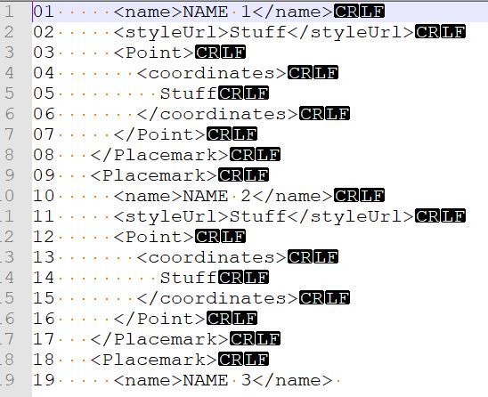

                                    Hello, @larlei, @terry-R and All,
                                    Given the INPUT text :
                                    And the regex S/R :
                                    • SEARCH (?-s)^\d+\h(\d+\h)([^<]+).+\R[^<]+(.+\R)
                                    • REPLACE \1\2\3
                                    I can affirm, like you did @larlei, that this search regex does not find any match at all, so cannot allow any replacement !
                                    Of course, I could explain why this regex fails, but, to my mind, it’s not important !
                                    Indeed, the main goal is that you should tell us :
                                    • Which is your text and/or your files involved, as INPUT
                                    • Which is the text or files expected, as OUTPUT
                                    Just provide us enough raw text to possibly build a regex S/R allowing the changes
                                    Be aware that, may be, you’ll need scripting to achieve your goals !

                                        Hi, @larlei, @terry-R and All,
                                        However, @larlei, given the same INPUT text :
                                        Then, the modified search regex of @terry-r, below, with an question mark, after the group 2 ([^<]+) :
                                        • SEARCH (?-s)^\d+\h(\d+\h)([^<]+)?.+\R[^<]+(.+\R)
                                        • REPLACE \1\2\3
                                        Does match and, after replacement, you get the expected OUTPUT text :
                                        01 <name>NAME 1</name>
                                        10 <name>NAME 2</name>
                                        19 <name>NAME 3</name>
                                        Let’s go back to the wrong syntax of the regex S/R, without the question mark. Why this regex does not find any match ? Well …
                                        • From beginning of line, it searches for some digits, followed with one horizontal space character, and this twice ( the part ^\d+\h(\d+\h) )
                                        • At this point, it tries to find some characters, all different from an opening tag delimiter <. But this case is impossible as an opening tag delimiter < follows, right before name>. So the overall search regex fails !
                                        • Now, adding the exclamation mark, after the group 2, means that all the group contents are not mandatory. Thus, it can be ignored and the following part .+\R does match the remaining of the first line, including its like-break ( \R ) !
                                        • And, indeed, I verified that, against our INPUT text, the optional group 2 ([^<]+)? is always EMPTY !
                                        In other words, you can simplify your regex S/R to this syntax :
                                        • SEARCH (?-s)^\d+\h(\d+\h).+\R\d+\h(.+\R)
                                        • REPLACE \1\2
                                        So, from the INPUT below :
                                        With this new S/R , you would get the same OUTPUT as above, i.e :
