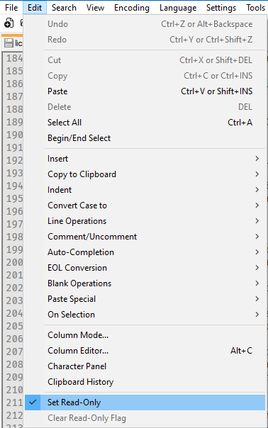

        A variation is to just tell Notepad++ that you want it to consider your file as not changeable. A way to do this on an already open file is via this menu item:

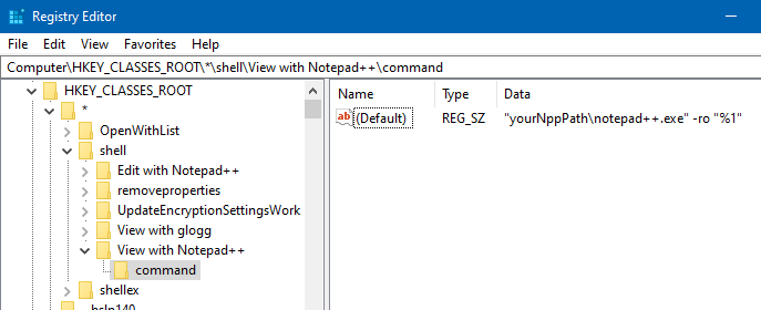

        You can make it an Explorer right-click item (on Win10, works for me at least, YMMV) by using the command-line argument idea and creating the following key and value:
        Obviously, you’d need to replace yourNppPath where I show it above with your own path to Notepad++.
        Note in the registry I show what I have for View with Notepad++ but I also have an Edit with Notepad++ that is similar but without the -ro command line argument.

            Using “ro” only effects NPP and does NOT change the Window’s attribute.
            NPP should be changed from “Read Only” to “Set Read Only Flag” to match the “Clear Read Only Flag”
