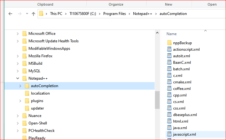

Are you sure you have the autoCompletion file in the right folder? User Defined Languages and Function List config files can go in
%AppData%\Notepad++\, but the AutoCompletion files must go in the<installDirectory>\autoCompletion\folder:Auto-complete files files are located in the autoCompletion\ subfolder of the Notepad++ installation folder (unlike some config files, these will not work in the %AppData%\Notepad++\ hierarchy).
– https://npp-user-manual.org/docs/auto-completion/#auto-completion-file-formatFor your reference, I have zipped up my portable copy that has a minimal combination of UDL, functionList, and autoCompletion working with the examples that you have shown. I will message you a temporary URL (only available for a few days) for downloading the zipfile.

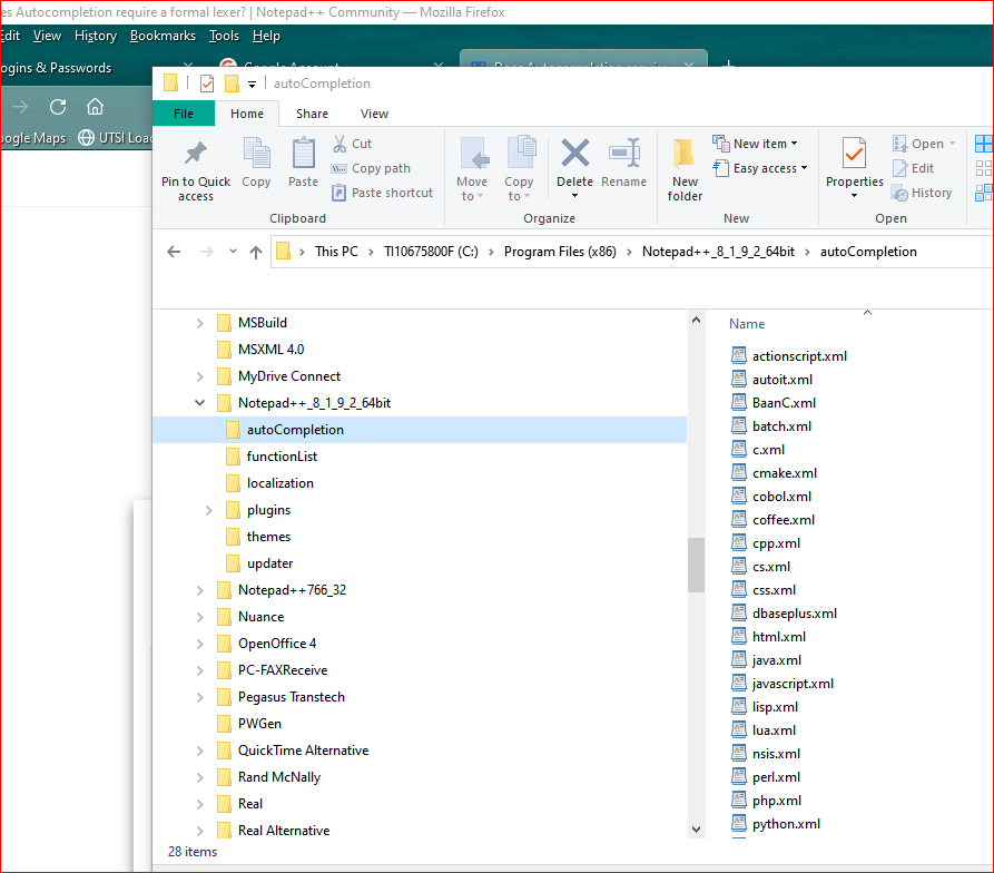

@peterjones , I figured it out, but now I’m also kind of confused about something, so…Yay on the one, and wow, on the second. :)
Apparently, I had to copy the file into the installed directory in the
C:\Program Files (x86)\Notepad++_8_1_9_2_64bit\autoCompletiondirectory. Now maybe I’m misunderstanding something, but I thought the 64 bit applications were installed in theC\Program Files\Notepad++\autoCompletiondirectory? I started naming the installed programs because when I had multiple copies of NPP I was getting confused because a 32bit would ask to update and I’d get a 64bit install, when I was trying to keep them separate and be able to run both. Maybe I’m misunderstanding how the 64bit and 32bit are supposed to be installed? Here’s my screenshots of what I mean.Program Files:
Here, they didn’t work.Program Files (x86), where it does work:
Am I confused about the proper separation of the two versions, or did I do something that’s supposed to be impossible? :)

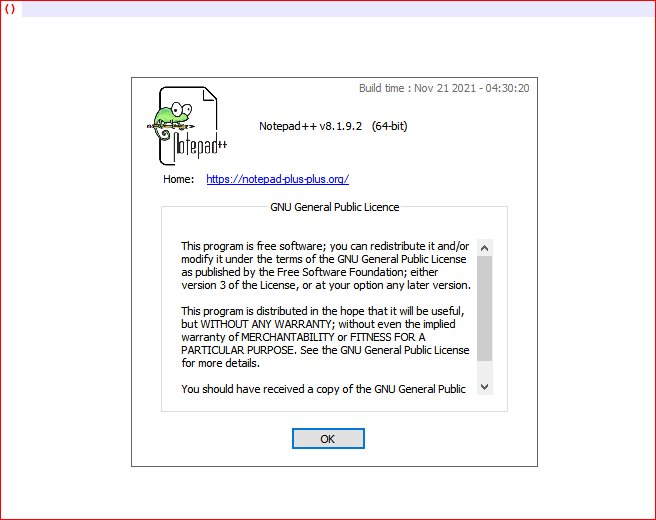

To head off a possible question here’s my debug along with screenshot of the version I’m using to do this.Debug:
Notepad++ v8.1.9.2 (64-bit)
Build time : Nov 21 2021 - 04:30:20
Path : C:\Program Files (x86)\Notepad++_8_1_9_2_64bit\notepad++.exe
Command Line :
Admin mode : ON
OS Version : 2009
OS Build : 19043.1348
Plugins : mimeTools.dll NppConverter.dll NppExport.dllScreenshot:
On a 64bit OS, it is generally set up so that 64-bit applications go in the
C:\Program Files\, and 32-bit applications install intoC:\Program Files (x86)\. I don’t know how you confused things so much – other than when installing programs, you can usually choose a different location to install into, and maybe you chose the wrong one when installing each.If I were the one doing it, I would uninstall both; install 64-bit Notepad++ in the right location, and just use a portable unzip on the rare occasions that I wanted to use 32-bit. It seems to me that having two installations using the same
%AppData%\Notepad++configuration would be confusing (and possibly causing problems) – especially if you are running both simultaneously.On my home computer, I have a recent 64bit installed, and I have portable zips available for most historic versions in both 32bit and 64bit since v7.6.3 to be able to help people in the Forum, starting from an out-of-the-box, so that my customizations don’t interfere with answering questions. At work, I have my primary NPP as a highly-configured portable unzip in one location (I was having to ask IT for
Program Fileswrite permission every time I upgraded NPP or tried a new plugin, so moved to a portable in a non-controlled folder, and just use user-level file associations to point to the portable version – thus not requiring elevated permissions. -

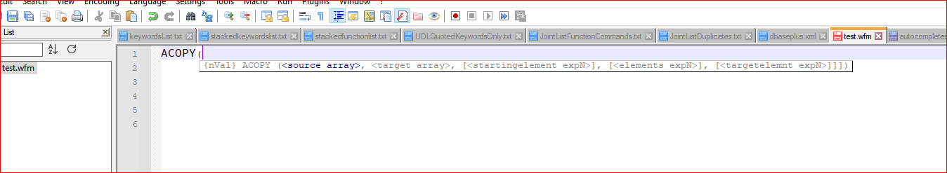

I have a little problem. I filled in a keyword function here:<KeyWord name="ACOPY" func="yes"> <Overload retVal="{nVal}" descrip="Copies elements from one array to another. Returns the number of elements copied."> <Param name="<source array>"/> <Param name="<target array>"/> <Param name="[<startingelement expN>]"/> <Param name="[<elements expN>]"/> <Param name="[<targetelemnt expN>]]]"/> </Overload> </KeyWord>But this is all that shows:
I’m missing some text and not quite sure why. Any ideas? I don’t see any out of place syntax highlighting in the text, even though it is long. Is there a limit to length before it’s ignored?

Hello, @lycan-thrope, @peterjones and All,
@lycan-thrope, why do you use :
<Overload retVal="{nVal}" descrip="Copies elements from one array to another. Returns the number of elements copied.">And not :
<Overload retVal="{nVal}" descr="Copies elements from one array to another. Returns the number of elements copied.">Maybe, this syntax explains the problem ? ( not tested ! )
Argh… Thanks.
I had made my self some skeletons to copy/paste to test some of the functions and parameters that I thought might give me problems before trying to do the file enmasse with the wonderfully written hints about how to mass format a keyword list…and apparently my hand typed abbreviations deviated from the proper abbreviations. :-(
Thanks… in my defense, it was another all-nighter and blurry eyes were present. :-)
