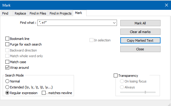

        Alan Kilborn @Ki An
        @ki-an said in how to keep only the texts in Quotation symbol and remove everything else?:
        either way is OK
        I’d suggest this marking operation (press Ctrl+m from the editor to get the Mark window up, then set up as shown and press the Mark All button):
        Follow that by a press of the Copy Marked Text button.
        If you don’t want the " to be present in what you copy, change the Find what expression to this before doing the Mark All:
        Ki AnK 1 Reply Last reply Reply Quote 1

          Ki An @Alan Kilborn
          @alan-kilborn Thank You, Solved :-)
