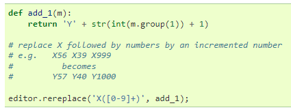

        However, you could do it with a scripting plugin such as PythonScript.
        From the docs is a hint at doing it:
        The rereplace function is called with the regular expression to search for and the function to be called to replace matches.
        So maybe for your case it would look like this:
        def add_12(m):
            new_page = int(m.group(1)) + 12
            return '/{:03}'.format(new_page)
        editor.rereplace('/([0-9]{3})', add_12)
