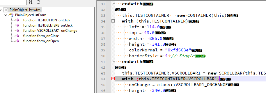

        There seems, according to this forum code highlighting, to be a difference in highlighting, that to me, says there’s a typo somewhere, that I’m not seeing in NPP. Screen 1 shows what looks to be normal, kind of going abnormal:
        And then Screen 2 shows what looks like something unclosed or different and abnormal:
        Will keep looking and thanks for at least, pointing out it works for you, so I will go back to seeing what the heck happened. errant keypress or whatever.
        Lee

          Well, one of the things I may have just discoverd is that after taking all those functions that were showing inside comments, and putting them in a class/endclass structure, they stopped showing in the functionlist. If I’m correct, then that means the problem may be in the post class function part, since after making them disappear, I copied them outside of the class structure, and they reappeared.
          Lee

            Well this is interesting. An overseas (to me) user found that by putting the open and close parens after the function function(), he was able to make the FunctionList not see it. I just tried it out and indeed, it works. Why, I don’ t get it, but apparently it does.
            Screenshot1 shows my code outside the class/endclass construct, representing a non-class function inside comments:
            Screenshot 2 shows that after adding the parens, and reloading the FunctionList, the commented code is now invisible to the FunctionList:
            So, I may have coded my regex improperly (other than the misnaming I did, that I fixed), or this is a weird bug maybe? The same code is used in the Class/Function class range, which is why I enclosed it in a class/endclass construct to see if was persistent or seperately problematic.
            Lee

              @lycan-thrope,
              Equally problematic is that looking at the screenshot now, I just noticed that the Class/Endclass construct, is not showing as a class inside the FunctionList.
              Hmmm…
              Lee
              • Lycan ThropeL
                Lycan Thrope @Lycan Thrope
                @lycan-thrope
                Never mind, just remembered it has to have an UNcommented function to show in the list. :-(. DOH!!

                              I’m trying to remove the Parens from around the this naming that shows the objects in our FunctionList, and am trying to pick off the end name or any combination to display without the this. I came up with this regex, that seems to do the job of isolating the last word in the parens and capture it in it’s own capture group, but I seem to be having trouble making it work in side of the functionList regex.
                              ([.](\w+)\))
                              As this screenshot of Regex101.com shows:
                              This is what comes up with your regex:
                              And what it shows when I try just assigning capture group 2 for the id with this ([.](\w+)\)) \2 in place of your \( *.? \) regex:
                              The problem seems to come when I try anything other than the original regex you developed Peter. I tried a couple of things to try and give an option of either this last word or this…kind of like (this | ([.](\w+)\)) and most often it comes up with the first (this) object and nothing else, or nothing at all, only functions. Is there a way to isolate the names without the this and the parens like a look-behind thing or am I way off base here?
                              Lee

                                    Well, I have hope I’m on to something here. Tried a different site to explain some of the look ahead/behind stuff and managed to come up with something that half works. :-)
                                    The first half works in that it changes (this) to this in the functionList panel for the first object which is the Form itself. I used this regex, probably improperly or need to phrase it differently\(\Kthis(?=\))|[.]\K\w+(?=\)) but the OR condition didn’t take, or it did but since the other objects have this with a dot in it, it disqualifed the condition and threw out the final objects instead. So now this:
                                     So now this:
                                    Looks like this:
                                    I need to figure out how to make the regex choose between supplying the captured group of either this by it’s self, OR if a match works that ends with a dotWordclosingparen, it displays just the word for that Object.
                                    If the above screenshot, the (this.TESTCONTAINER.VSCROLLBAR1) is a child object of the TESTCONTAINER, but…the VSCROLLBAR1 is an obect in it’s self. If I can capture the whole thing after this without the parens, but the dot between the two objects that would be considered a success since it at least cleans it up, but I am tryig to just pick off the last object name so the list would just include the objects themselves for navigation purposes when using the FunctionList panel…so I’m still working on it, trying to see how to make it work.
                                    Lee

                                        Okay, now we’re cooking with gas. :-)
                                        I figured out how to exclude the parens with \K(.*?)(?=\)) and here’s what it looks like:
                                        I fear, however, keeping the this for the first object, and removing it from the rest is going to be a bit harder…but maybe not if I can figure out how to make the or work and figure out how to keep the this keyword if followed by the closing paren, but not if it’s follow by a dot operator, and use the rest of the object description instead. This is kind of fun…and kind of frustrating at the same time. :-)

                                            Well, success for the most part for the original goals. :-)
                                            Of course, as usual, goals shift. :-)
                                            I used Peter’s or break down and added additional ones that started with the longest number (in this case, and unfortunately only this case) 3, and had two more or’s with the whole regex up to the point of the opening parens being starting the reset, and changed the capture portion.
                                            \Kthis\.\w+\.\K\w+(?=\))|\)this\.\K\w+(?=\.)|\(\Kthis(?=\)) picks off the longest extended name and does it first, followed by the next section with this regex:
                                            \Kthis\.\K\w+(?=\)) to pick off any objects immediately after the dot operator following this to capture that object and then folowed by:
                                            \K(.*?)(?=\)) which captures the this object before the closing parens.
                                            Screenshot of new FunctionList panel at work:
                                            So this was the original hope of being able to do, but after looking at it, since I can’t do replacement text, it makes sense to keep the object list together past the first one following the this, as that denotes a parent object TESTCONTAINER and the lineage to the child object VSCROLLBAR1.
                                            So now my next goal, is to try and check after the initial object after the superparent this is set alone to allow any other objects that have children to continue being sucked into the capture and listed as is, in this case TESTCONTAINER.VSCROLLBAR1. So back to the drawing board on figure out how to test for a following dot operator without stopping the accumulation from stopping at the point. The look-ahead (positive?) worked to identify and not include the closing paren or the dot operator, so now to test a negative lookahead?
                                            Thanks for help so far Peter, et al. It’s fun again for the moment. :-)
