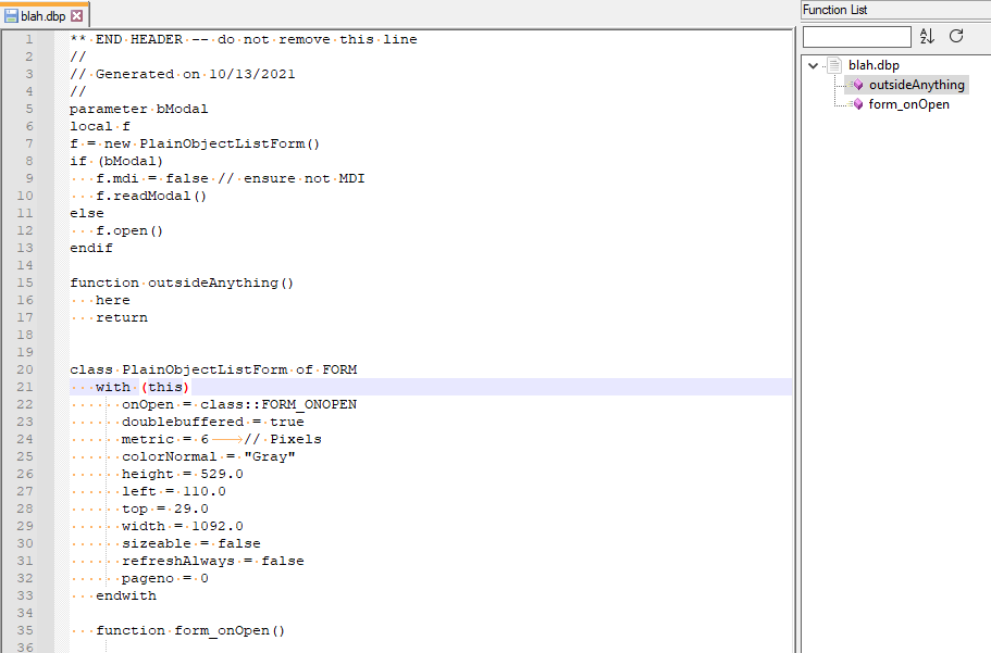

                                        Okay, so no after beating the keyboard and my head all day, I figured it was time to present what I have tried and still doesn’t work…but to be fair, all I’m trying to do is get FunctionList to see my class first. Baby steps.
                                        This is my functionlist file:
                                        |   link:
                                        <NotepadPlus>
                                        	<functionList>
                                        		<!-- ========================================================= [ dBASEPlus ] -->
                                        		<parser
                                        			displayName="dBASEPlus"
                                        			id         ="dbaseplus"
                                        			commentExpr="(?s:/\*.*?\*/)|(?m-s://.*?$)"
                                        			<classRange
                                        				mainExpr="(?x)                                                                 # use inline comments
                                        					^[\t\x20]*                                                                 # leading whitespace
                                                            class							# class keyword
                                        					[\t\x20]*(\w+)							# class name
                                        										# Following the class name there is the option of parameters, and if so
                                        										# the first entry inside the parens is required, whether there is other
                                        										# parameters or not, once the parens go up, the first is required. ie:
                                        										# class FrameCtrl(frameObj)
                                        					([\t\x20]*?\(\w*	# first and required parameter
                                        					((,[\t\x20]?\w*)*)?\))?			# the following optional/additional	parameters
                                        													# For the rest of the class declaration, after the class name
                                        													# all other options are part of one big optional set, that
                                        													# follows 'of' and can be populated by one of several
                                        													# options. The first and most prevalent is the Superclass
                                        													# name that the class is being subclassed from, and it's
                                        													# options of parameters and again, if it has parameters at
                                        													# least the first one is required ie.:
                                        													# class class ToolButtonFx(oParent) of Toolbutton(oParent)
                                        					(([\t(\x20]of)[\t\x20]\w*(\(\w*((,[\t\x20]?\w*)*)?\))?
                                        													# The next possible option is that it is a custom object and
                                        													# needs to be in this line so if the object or form is opened
                                        													# up in the dBASE IDE, the designers in it won't mess up
                                        													# the object by streaming out missing parts or overriding
                                        													# properties or objects and functions.
                                        					([\t\x20]custom)?
                                        													# The next option is that the class is being subclassed from
                                        													# another object that is contained elsewhere and the compiler
                                        													# needs to know this reference.  There are two options for
                                        													# pointing to the file. The first is an Alias path in the IDE
                                        													# that can be accessed by the compiler in the environment, or
                                        													# second, it is in the current directory and only the name is
                                        													# needed...or it has a path that can be listed here, but this
                                        													# is bad practice, and an Alias is recommended if the file is in
                                        													# a place other than the current directory. If it is, the name
                                        													# can be used in quotes as a string that gets passed to the
                                        													# compiler. Both follow the word 'From'. The Alias directory
                                        													# is a name that is enclosed in two colons, one immediately
                                        													# before the Alias name and one immediately after, no spaces.
                                        					([\t\x20]from[\t\x20](:\w*:\w*\.\w*| \x22 \w*\.\w* \x22))?)?   # end of class declaration line
                                        				closeSymbole="endclass"
                                        				<className>
                                        					<nameExpr
                                        						expr="(?x)
                                        						[\t\x20]*?
                                        						^class					# class  keyword
                                        						[\t\x20]*
                                        						\K(\w+)                   # Class name
                                        				</className>
                                        				<function
                                        					mainExpr="                                                                     # function body
                                        					<functionName>
                                        						<funcNameExpr
                                        							expr="                                                            # function parameters
                                        						<funcNameExpr
                                        							expr="
                                        					</functionName>
                                        				</function>
                                        			</classRange>
                                        			<function
                                        				<functionName>
                                        					<nameExpr

                                          PeterJones @Lycan Thrope
                                          @lycan-thrope ,
                                          Without any functions defined, the classes don’t show up in the list, even if they do match your text, so you aren’t going to be able to see it work without a function (even if it’s the simplest possible function).
                                          If you want to individually test the regex, you can use the FIND or MARK dialogs with the same expression, which makes it easier to try variants.
                                          If I try your class expression in the FIND dialog, it says that it’s an invalid expression.
                                          When defining a new parser, I generally skip the openSymbole and closeSymbole expressions, and just deal with the mainExpr.
                                          Next, the way I do it, the mainExpr needs to match all of the text in the class – so the whole class … endclass – not just the introductory line, because it only finds class-functions (ie, methods) if they exist inside. If I’m reading your expression right, it’s only matching the single class line. (Maybe with the closeSymbole, you no longer need mainExpr to match as much… but I wouldn’t trust that without more experimentation.)
                                          And when debugging, I try to make the main expression as simple as possible, especially at first; if it needs more complexity later on, I add it… but for helping you get something tot; when debugging it, I start with the simplest form. Which, I think for yours, would be "match from class to endclass. So I’d be tempted to start with mainExpr="(?xms) ^ \h* class \h+.* ^ \h* endclass" – when I use that in a FIND in your document, it finds from class to endclass as I think I expect.
                                          Your class name expression looks reasonable, and does match the class name.
                                          For simple testing, I would then define the function mainExpr="(?x) \h* function \h+ (\w+)"
                                          But, as always, something goes wrong when I try things starting too complex. So I comment out the classRange, and just start with a simple function section:
                                          			<function
                                          				<functionName>
                                          					<nameExpr expr="(?x) \h* function \h+ \K (\w+)"
                                          				</functionName>
                                          			</function>
                                          If I do that, and add a block before your class
                                          function outsideAnything()
                                             here
                                             return
                                          (might not be valid, just using it for the parser), then reload when the dbaseplus.xml parser is properly linked in the overrideMap.xml, and the existing file is associated with the dBASEPlus UDL, I get:
                                          … so that means I am doing something right so far.
                                          But when I try to use that same <function> block inside the <classRange> block, it won’t find the class (and no longer shows the form_onOpen)…
                                          Unfortunately, while I’m usually able to get it eventually, it takes time for me. And I’ve spent as much as I can on this for now. maybe I’ll have spare time later today to work on it. But, if nothing else, this will give you a good starting point, because with the classRange commented out as here, it finds two functions, which is at least a starting point for debug:
                                          |   link:
                                          <NotepadPlus>
                                          	<functionList>
                                          		<parser
                                          			id         ="dbaseplus"
                                          			<!--classRange
                                          				<className>
                                          					<nameExpr
                                          						expr="(?x) [\t\x20]*? ^class [\t\x20]* \K(\w+)"
                                          				</className>
                                          				<function
                                          					<functionName>
                                          					</functionName>
                                          				</function>
                                          			</classRange-->
                                          			<function
                                          				<functionName>
                                          				</functionName>
                                          			</function>
                                          		</parser>
                                          	</functionList>
                                          </NotepadPlus>
                                          and
                                          ** END HEADER -- do not remove this line
                                          // Generated on 10/13/2021
                                          parameter bModal
                                          local f
                                          f = new PlainObjectListForm()
                                          if (bModal)
                                             f.mdi = false // ensure not MDI
                                             f.readModal()
                                          else
                                             f.open()
                                          endif
                                             here
                                             return
                                          class PlainObjectListForm of FORM
                                             with (this)
                                                onOpen = class::FORM_ONOPEN
                                                doublebuffered = true
                                                metric = 6	// Pixels
                                                colorNormal = "Gray"
                                                height = 529.0
                                                left = 110.0
                                                top = 29.0
                                                width = 1092.0
                                                sizeable = false
                                                refreshAlways = false
                                                pageno = 0
                                             endwith
                                             function form_onOpen()
                                                form.testcontainer.vscrollbar1.currentValue = ;
                                                                         form.testcontainer.vscrollbar1.value
                                                form.testContainer.aContainers = new array()
                                                form.testContainer.ncontainers = 0
                                                form.testContainer.nSpacing = 2
                                                return
                                          endclass
                                          Sorry I couldn’t get more working yet…
